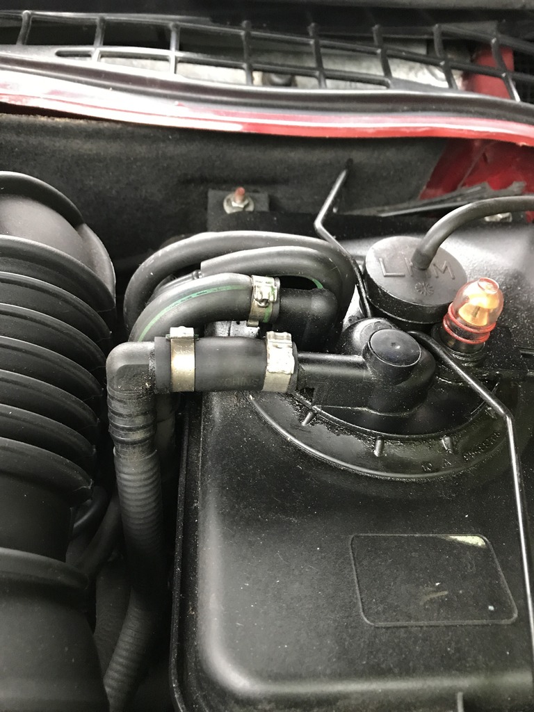

IMHO, your original diagnosis of 'air' in the hydraulic symptom was correct. 'Surging' brakes is a fairly common Xantia problem that has been much, and at times hotly, debated on this forum over the years, with various members, me included, seeking advice. The general consensus seems to be that the cause is 'gas' in the hydraulic system. Bleeding can effect a temporary cure, but the problem returns.
My logical analysis
The hydraulic system is self-bleeding apart from the brake lines which dead-end at the callipers; you have bled those but the problem has returned.
There are only two possible sources of gas in the system:-
1. Nitrogen leaking from a failing sphere. You have replaced all spheres, and it's improbable, but not impossible, that you have installed a defective new one.
2. Air from the atmosphere. The hydraulic system is under positive pressure through-out, except for the supply from the hydraulic reservoir to the pump. The HP pump sucks fluid up from the reservoir, the flow through the filter
The cure
The one part of the hydraulic system that you haven't tackled is that supply, which consists of two parts, the reservoir 'head' unit and the pipe from the top of it down to the pump.
Have you cleaned BOTH tank filters? Wash in petrol, using a soft toothbrush with a long handle to very gently clean the mesh (it will have become brittle and fragile with age). This won't fix the underlying problem, but will improve the flow to the pump and thus decrease the negative pressure and thus the tendency for air to leak in.
The highest point in the suction system, and thus the point of lowest static pressure, is the joint where the 'rubber' supply hose fits onto the stub of the plastic reservoir head. In my experience, the hose, which can't easily be replaced (NFP), gets slightly stretched widthways by being pulled off over the 'olive' in order to remove the filters for cleaning, and having become hard with age has lost its elasticity and become slightly loose. The 'trick' is to push it firmly in against the swell of the 'olive' - trimming a few mm off the end of the pipe if it butts up against the moulded bend - before re-tightening the clip just enough to hold the pipe firmly in place. If in doubt, wash the end of the pipe and the exposed part of the stub with brake cleaner and apply some silicone sealer.around the joint - looks a bit messy but better than air being sucked in.
I had this happen to me twice in the 11 years we had our Xantia. During our first year of ownership (should that be guardianship?), when a failed sphere (O/S/R) prompted a full hydraulic service (spheres, drain and clean reservoir, bleed out all the old LHM). Took me ages to find the probable cause. Second time around was some years later after I had overhauled the rear brakes (calliper corrosion, new bolts, discs and pads, clean filter and change LHM). This time around, I immediately went for the suction hose, refitted it more carefully (didn't need silicone) - surging brakes cured!
For the benefit of others, and my curiosity, could you let us know how you get on?

Thank you for that in depth reply Guy. I should have mentioned that the steering is currently quite heavy at idle which made me assume the tank filters need attending to. And funnily enough, the only reason I haven't yet done that job is to make sure I didn't disturb the feed pipe!
I will get that seen to hopefully this weekend and with a bit of luck that will be the cure! Will it need a brake bleed again afterwards, my guess is it will?
Thanks again Guy.
Thanks again Guy.

Dommo wrote:I will get that seen to hopefully this weekend and with a bit of luck that will be the cure! Will it need a brake bleed again afterwards, my guess is it will?
I think you're probably right. But I'd wait and see if the brakes still 'surge'. If you've changed the LHM fairly recently (and bled the brakes thoroughly to purge the lines of all that old yellow stuff), then what you get out should be clean, clear, bright green LHM that can go straight back in the reservoir.
I 'invested' in a proper pair of hose-clip pliers some years ago (about £17 IIRC). They make removing/replacing the 'proper' hose clips sooo easy; Click off, click on. Thus it's easy to remove the reservoir to empty it thoroughly and wipe it clean inside with kitchen roll (good quality, you don't want to leave little bits of paper inside). I know lots of people throw the OEM clips away and use screw-up hose clips instead - I don't like them, too easy to over-tighten and crush the plastic stubs.
If you need some let me know (and what colour code), I can probably find a few salvaged from a scrapper.

Right then chaps, slow reply here I'm afraid but I've been doing a bit more than just messing with brakes, have swapped over the front ram for a good unit from my old Activa, literally had 6 months of use. While I was there I drained and cleaned the LHM tank, not particularly dirty, and nor were the filters. They weren't 'clean' but they certainly weren't particularly dirty either.
With the feed pipe to the pump, can't say as I've ever seen a pipe like this before
It could be standard procedure for early cars but certainly my '99 Activa and '97 1.9TD and 2.1TD weren't like this. It's handy though because replacement of that hose costs a pittance and is very easy, unlike on my 1.9 where I had to change the whole lot due to a split in the pipe - and I was chasing an air leak so replaced it out of completeness.
I can't say what the brakes are like yet as it's still going to be in bits for a good few days while I tend to an LHM leak around the back of the car, but I'll keep you posted.
Stewart I will try lubing up the steering UJ, not something I've tackled yet though.
Cheers all.
Cheers all.
