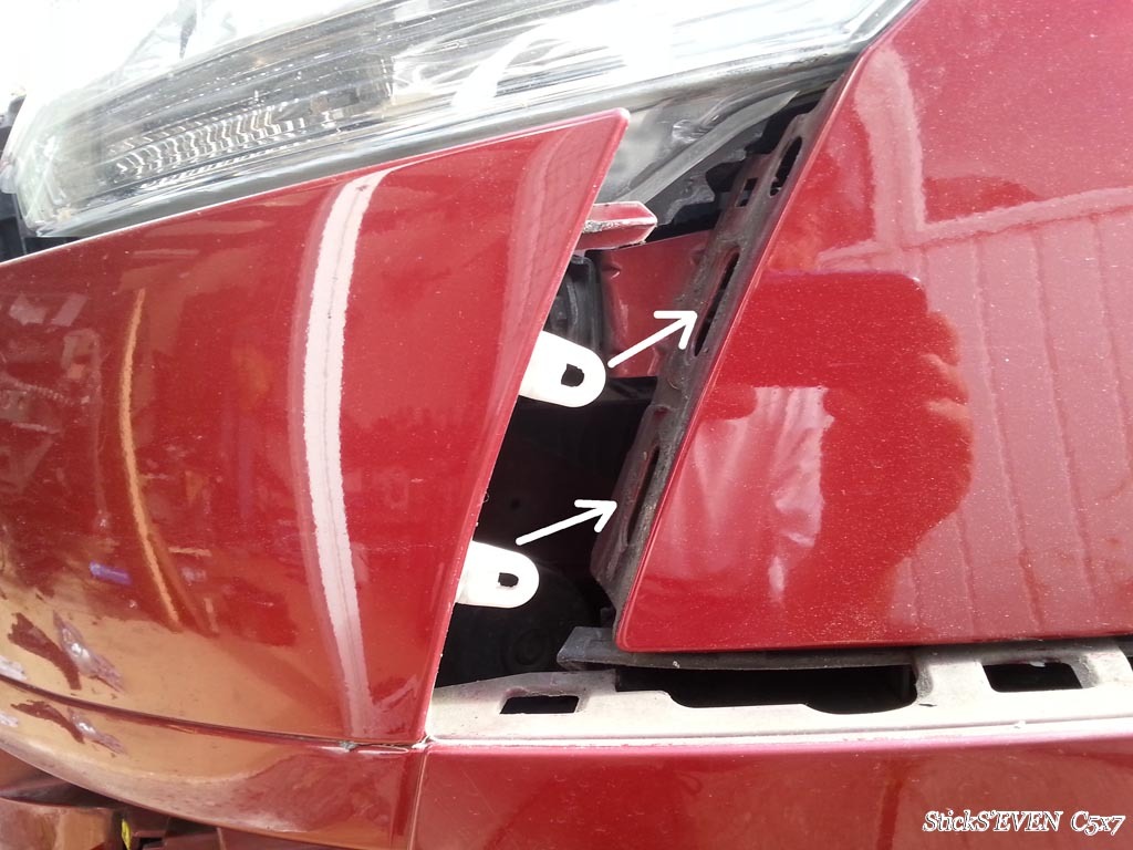

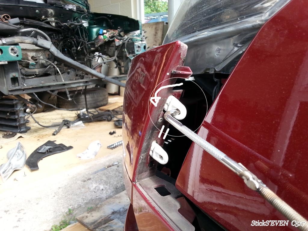

I made an extension tool to turn the nylon lugs

Thank you Sticky, I've removed and reinstalled bumper once about three years ago, and I don't quite remember what else had to be dismantled before those nylon lugs. That official guide had every step nicely documented. I wish I wouldn't break anything this time. I broke one of those lugs because I twisted it in the wrong direction. Luckily the other on same side was enought to keep bumper in place.
