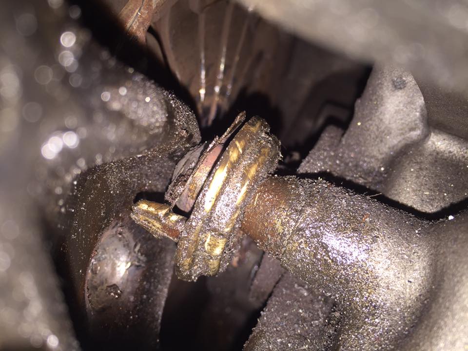

I took this photo from the slot where the clutch fork goes inside the engine... You can see that fork has disconnected itself from the plastic part that holds it to the pivot, and also some of the clutch seem to have some fresh-looking scratches. Do you think these scratches could mean a new clutch kit?
Cheers, Dan.

You always change the complete clutch kit,very foolish not to. Also the release bearing will have damaged the fork and the guide sleeve,so change the lot.
