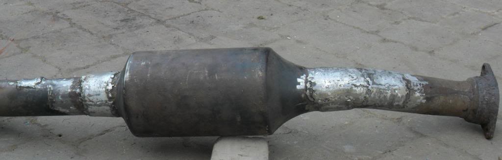

If it's anything like the Xantia one, you might end up with something like this (the second time I welded it up!)
If it is like the Xantia, then getting it off the car is awkward - there is limited access to the top of the OS bolt - I ended up cutting it off (twice) - but then you can't get the stub out so have to cut the other end off - which is next to impossible (I considered whether I was going to have to take the engine out!). Reportedly there is access from the top to get a spanner on it....

Thanks for that Richard. I think I might be better getting in with it still attached to car. Inverter Stick welder may be my tool of choice. Put a bend in the rod to probe it in by the looks of it. Never get in with the Mig torch.

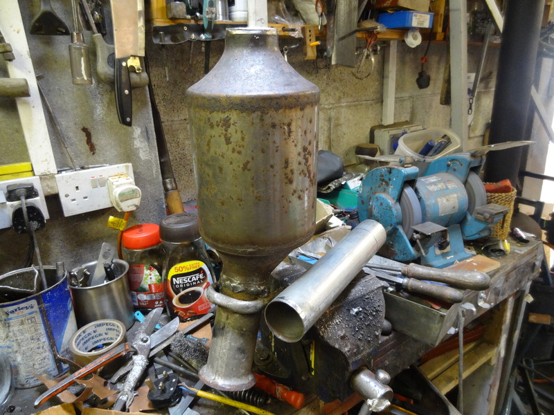

Re: The Donk!
All done and back up running. Here is the cat. First pic I have cut off old pipe and measured a new section. I have beefed up the joint where the hanger is.

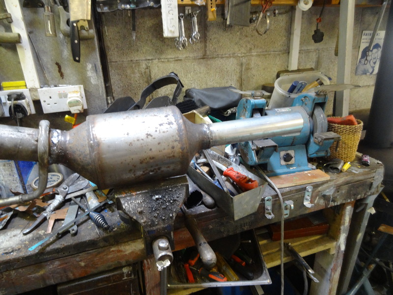

This is it welded up.
