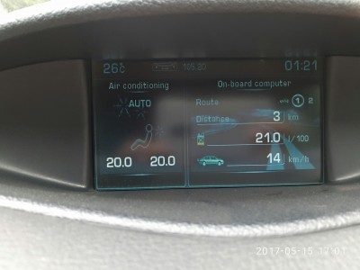

So I have replaced all the coils and spark plugs since I had a #2 coil fault awhile ago and the fuel economy continues to be very high. In fact, it is now higher than before. Dinner owning the car and having driven it for about 1000 km so far the fuel economy avg at 21 L / 100 KM or even higher. I barely get 280 km of range with one tank.
I have no other fault code relating to the engine and when I drive it hard the power is good all the way to redline with no power gaps or stutter. And the idle seems stable.
What should I be looking for? Ex: What range sound the O2 sensor be before the cat?
Thank you all for your suggestion and help.
