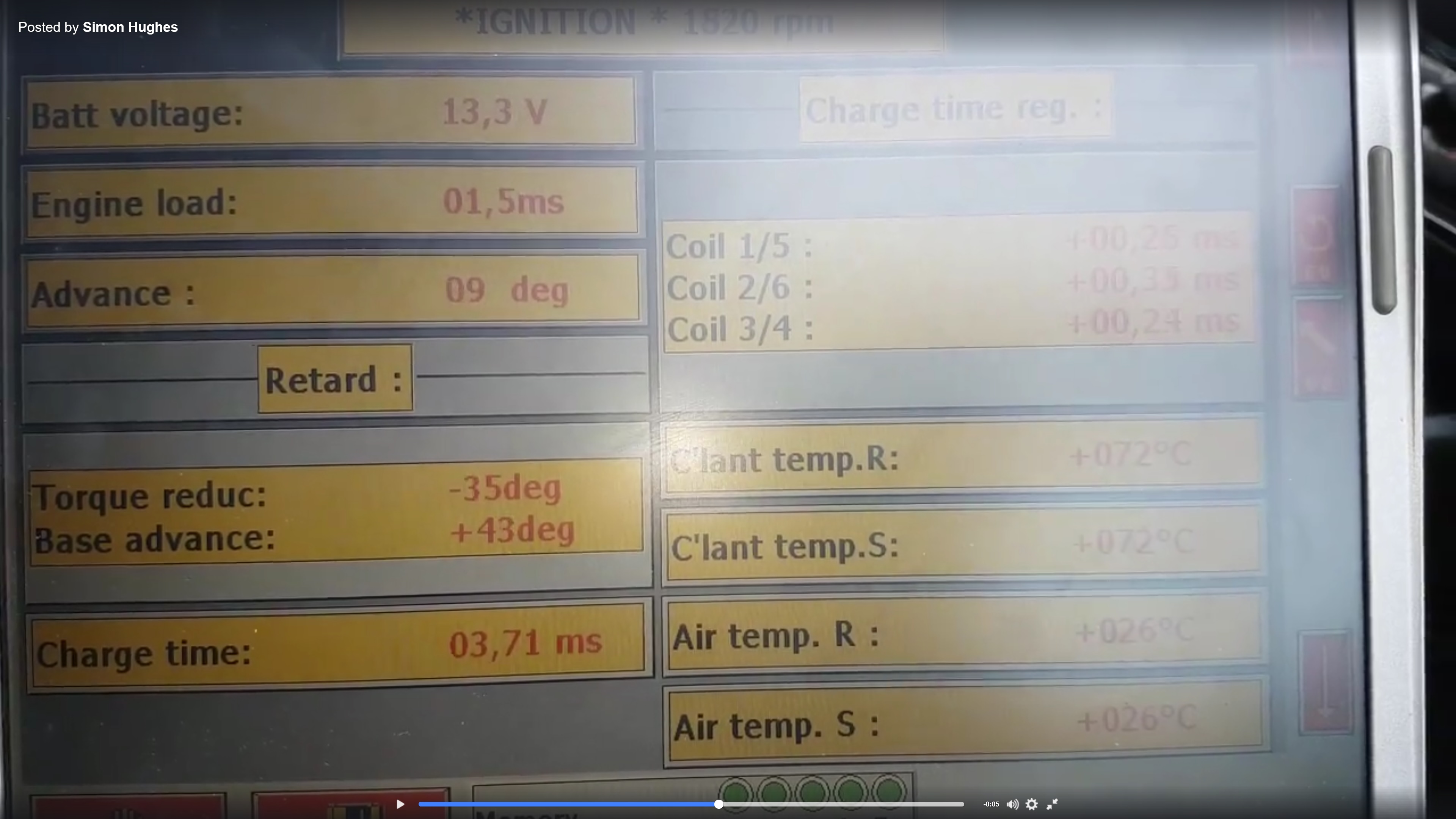

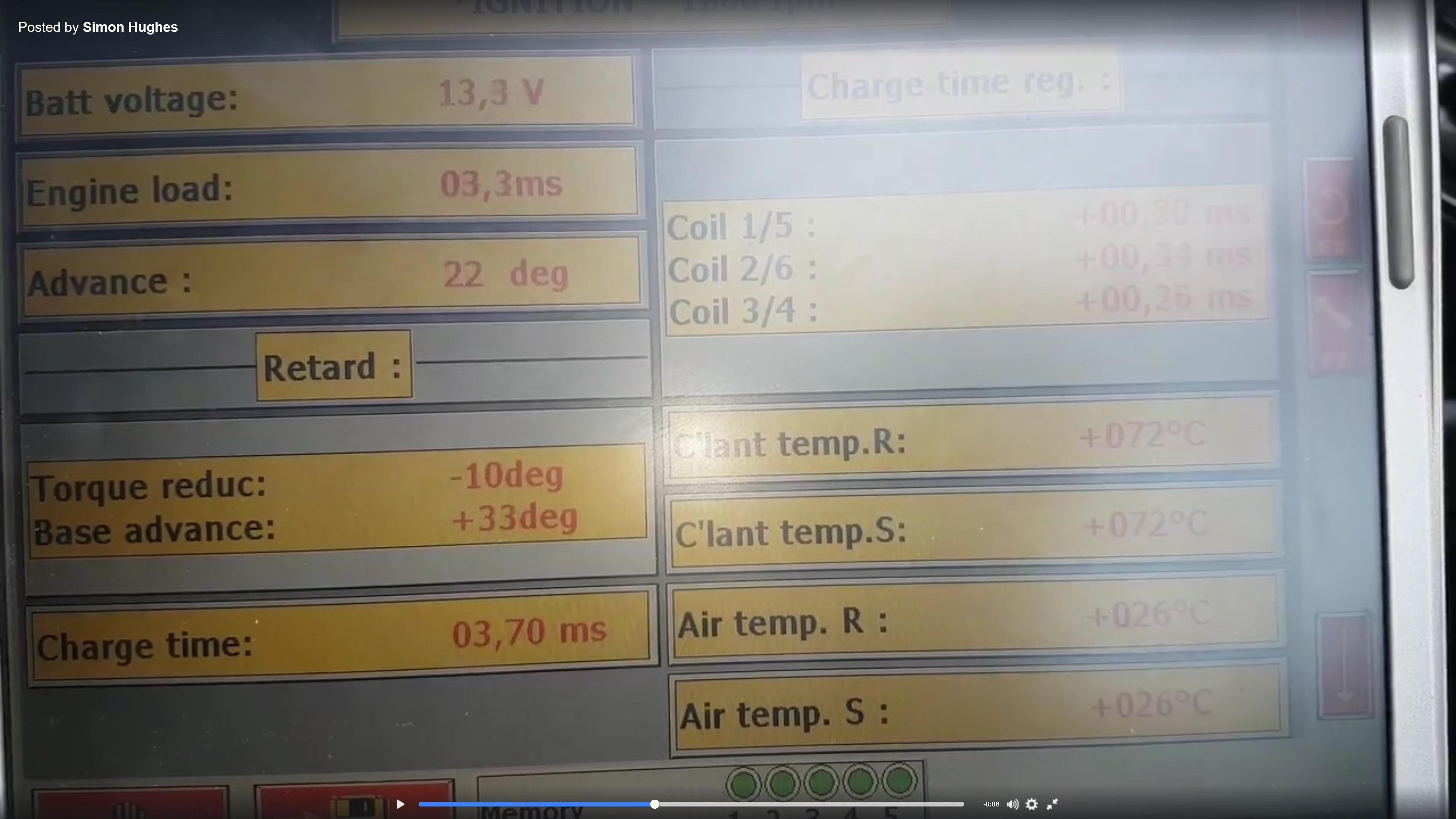

but on the way to her MOT, picked up a misfire :
heres are screen shots from lexia
the restard is varying a lot! but the click test from the coil pack(s) passed?

The Lexia won't be much use in diagnosing a misfire on the Xantia V6 unfortunately - the ECU is too "simple" and has very limited diagnostic ability. Although a coil primary fault would probably show up in the charge times for the coils, any sort of secondary fault (which is far more likely) like an open circuit spark plug lead, broken insulation in a spark plug lead, faulty spark plug, oil in the spark plug wells etc wouldn't be shown, and in my experience, isn't shown, as the small variations shown on your screenshots look normal to me.
