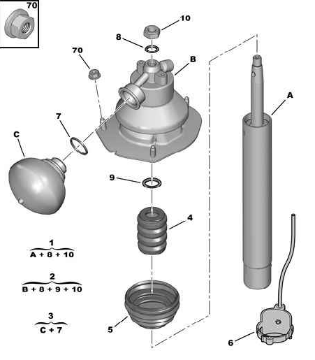

I think you'll find these are model-dependent. Dimensions are not listed in the service pages unfortunately.
Item 4 is the Rebound Stop and is Part No: 5033 66.
They only cost about £5-10 in the UK, but shipping costs vary - although the Royal Mail does ship letters and small parcels for about £10 international tracked / signed:
http://www.royalmail.com/hong-kong Edit: According to another site, these are the dimensions:
Fitting Position: Front Axle left and right
Outer Diameter [mm]:53, 57
Thickness [mm]:115
Inner Diameter [mm]:30
Weight [kg]:0,08

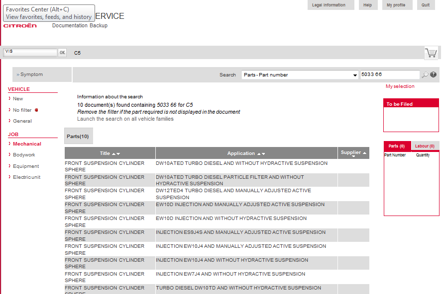

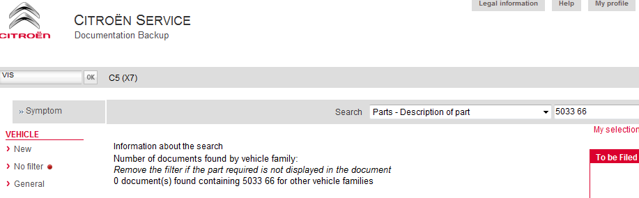

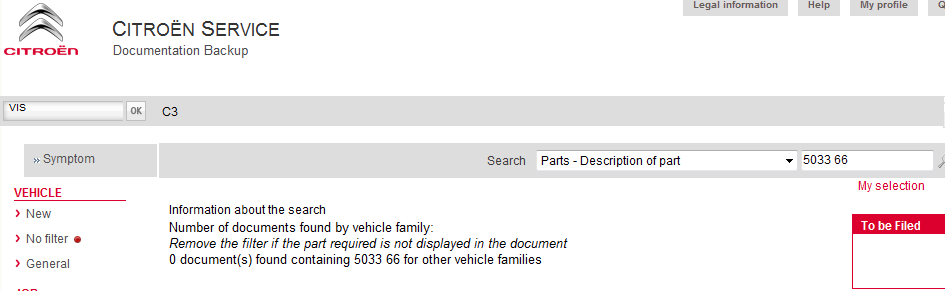

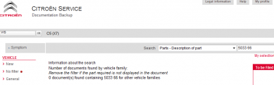

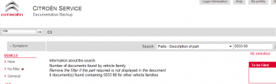

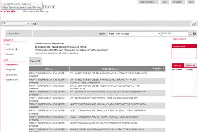

and no results are returned - as I said. You can't get to the search without selecting a model first. Then searching on this part will not bring it up on any category except when searching within a C5 MKI or MKII as the base vehicle regardless if running it again against all families. If I repeat with the C3 (Pic 1) or a X7 (Pic 2) selected and no filters all families - nothing. Using the C5 MKI as the base vehicle it will now show up against all the relevant C5 MKI models for each engine (Pic 3). From what you are saying, then this part should of showed up on either of these searches regardless of the base model, which is clearly doesn't. I can see I'm going to have to put some screenshots up to convince people
No Part All Families, no filter C3 No Part All Families, no filter X7 Mark I C5 Part is shown

Can you post some screenshots Chris? Maybe we can see where the difference is. Using 5033 66 as an example might help the OP.
