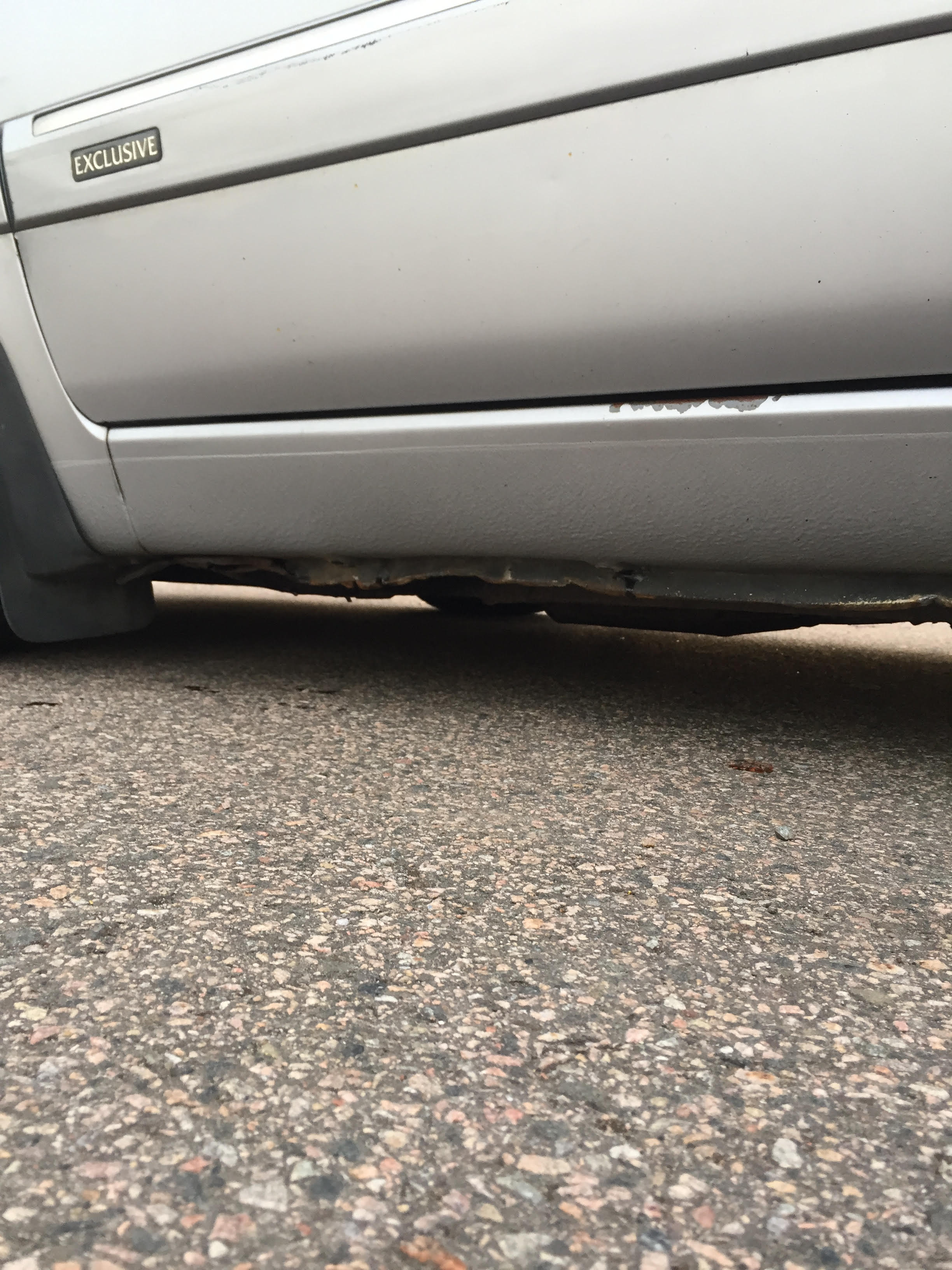

New to the Citroen world. I always been attracted to a older Citroen, (XM or Xantia) and now i have a Xantia!
I really LOVE it. Never felt that about a car before. So normall i shouldnt really bother about this, but since i really are obsessed over rust and all. i wanted to ask you who know about this (yes, i suck at cars and mechanic!)

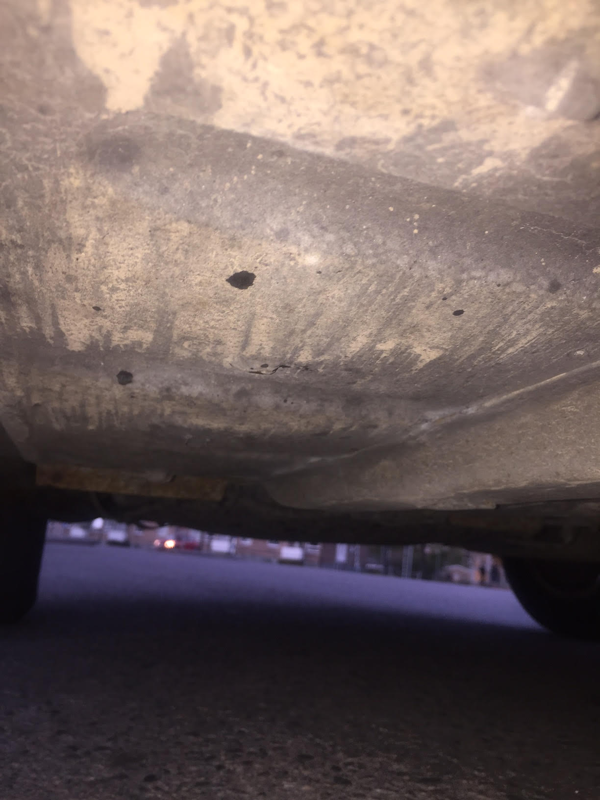

A friend took a look under my car today. And said "Oh my god! This isnt good or even okey. This is BAD!"
I took some photos from my phone, because i wanted to ask someone else. He knows about cars sure, but i just want to deny it.
Then again, being honest is better in the long run. If its really junk, then it is.
I cant tell the condition of a car just looking under it. I just see "stuff" there and i suppose its always a bit dirty under a car. So.. i will show you the photos and wish to hear just how bad this looks to you?
So here i can see that its really bad 8-[

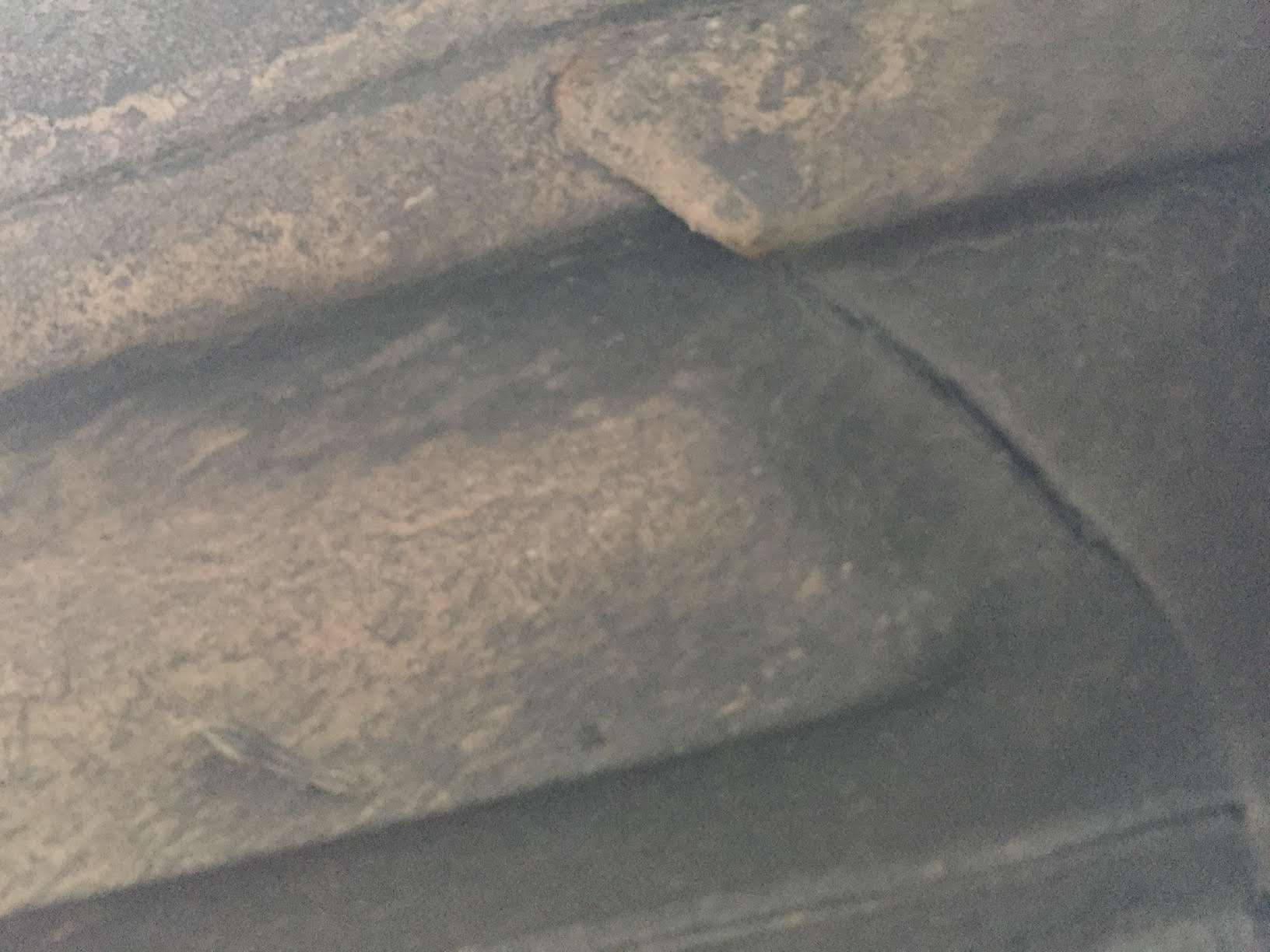

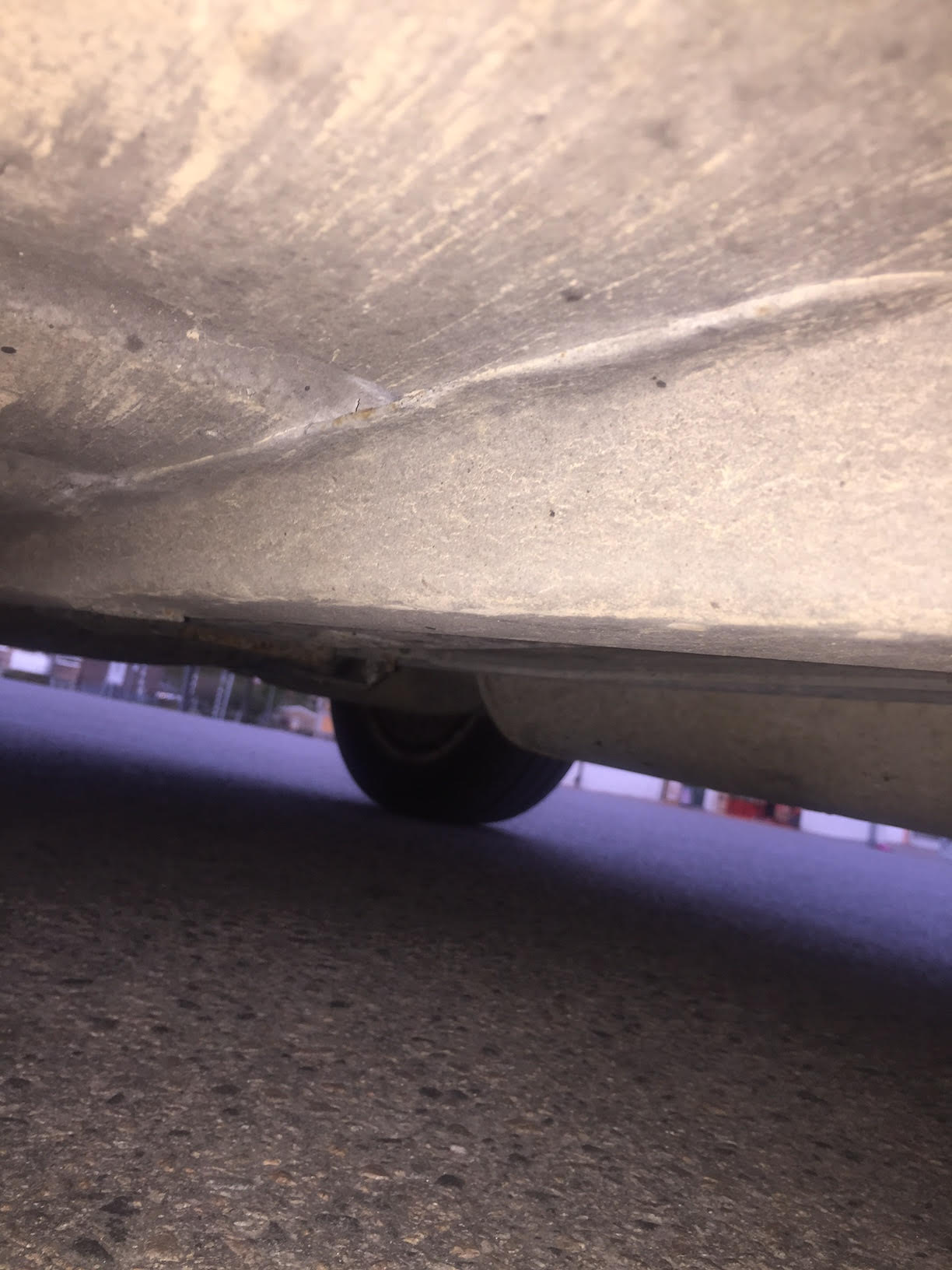

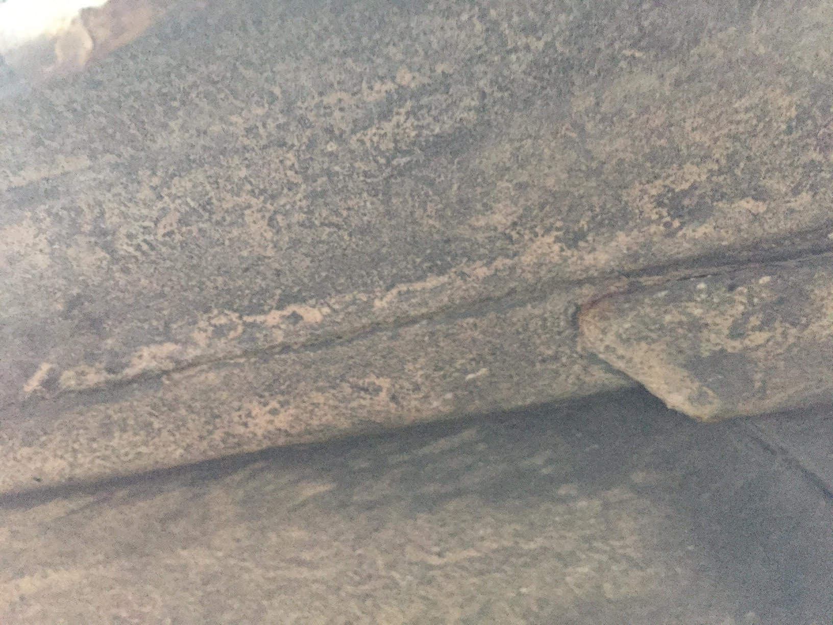

Here is where i cant tell if its good, okey, bad or really crap:

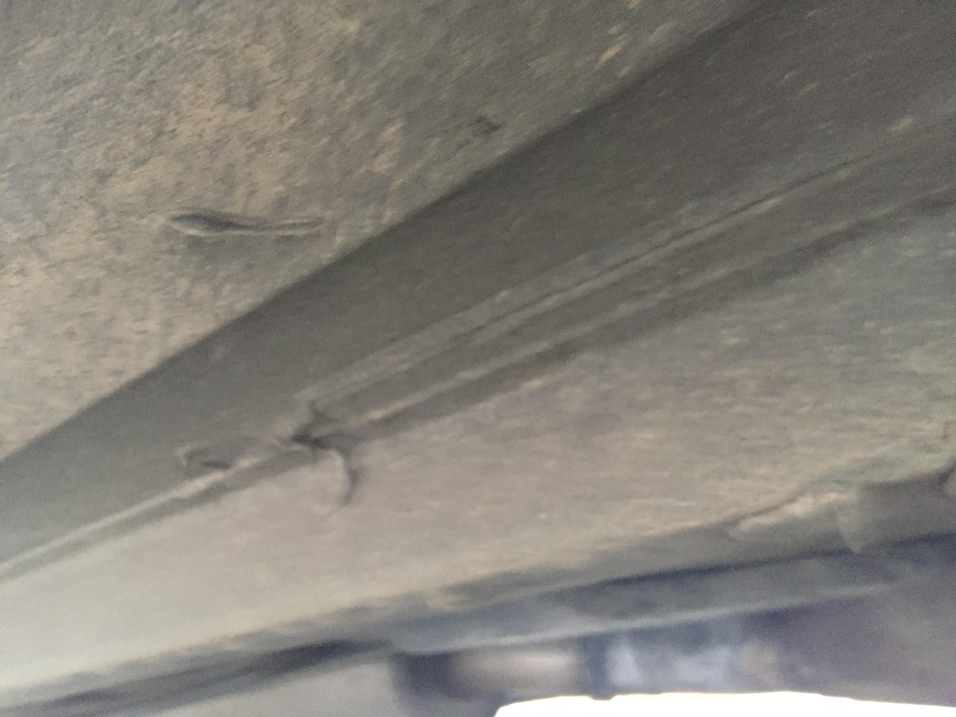

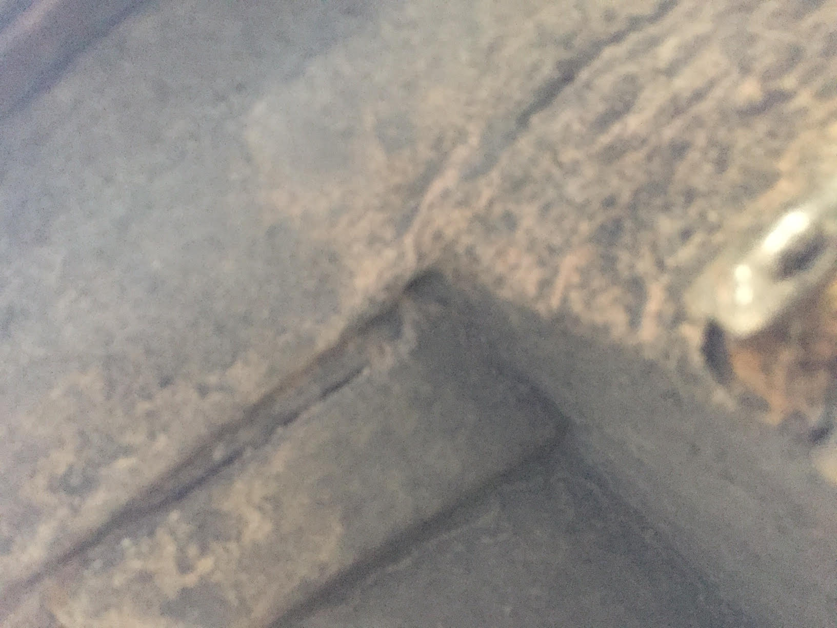

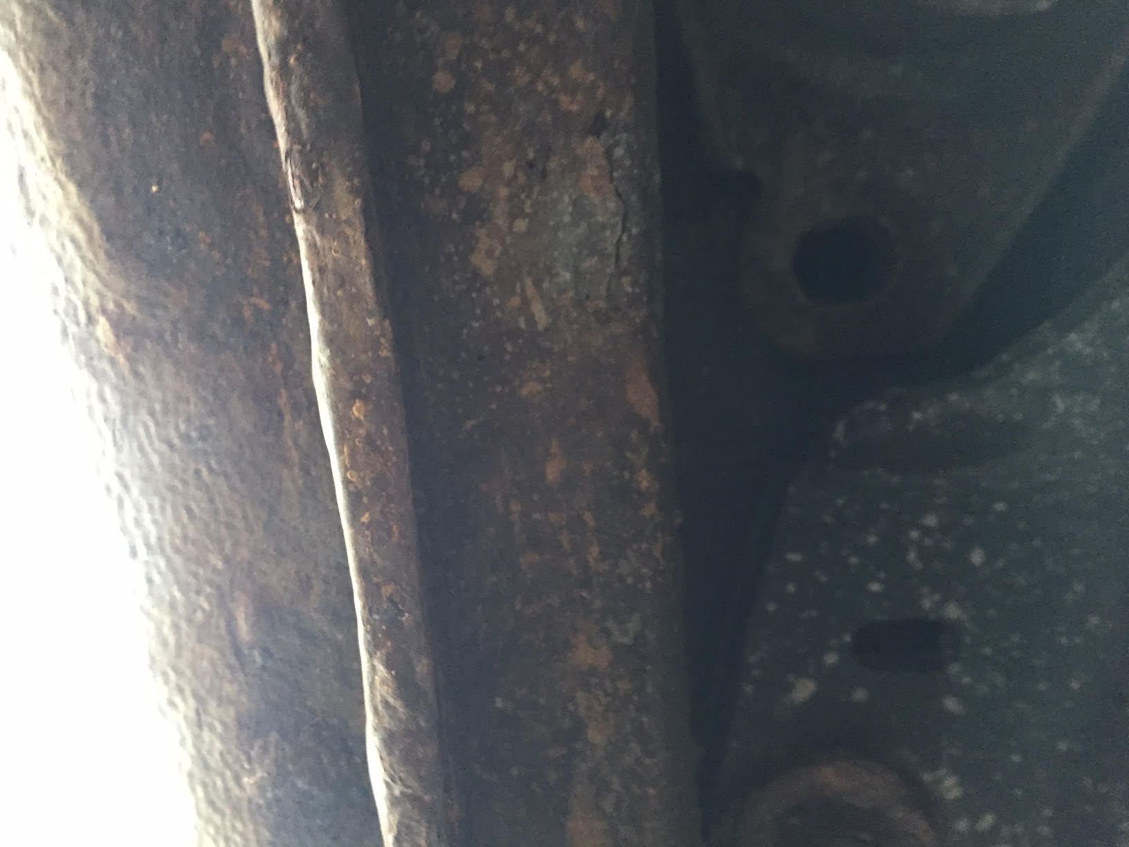

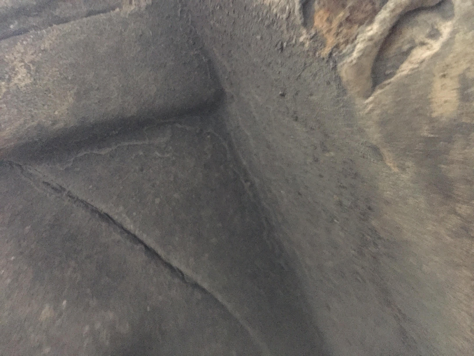

Your friend is talking nonsense. That looks clean as a whistle to me! That's just surface corrosion that can be ignored.

First photo is your standard jacking point abuse but doesn't look to have gone rotten so should be fine to straighten out and paint/underseal.

Put it this way, if I saw a Xantia that clean underneath here in the UK I'd snap it up like a shot!

From what I can see there are no problems of worth there.
There may be some areas that can do with some light repair to the under-seal (using products from the DINATROL I recommend) as would be expected with any car 20(ish) years old.
There are some good guides on-line on how to do this.
Common places to check are the Sill End plugs, rear subframe (the rear ones) mounts and the areas around the door/sill junction and behind the front wheel arch liners/door pillar for mud build up esp if you have mud flaps fitted.
