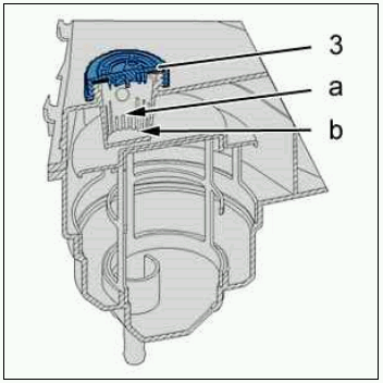

Are / have there been any leaks where you keep the car overnight. Have you checked the level of LDS fluid in the reservoir - with the suspension on LOW setting, engine running, the level should be between the 2 lower visible marks of the tank neck (A & B): Can you also describe in a bit more detail what is or is not happening? Will the car raise and lower or will it not rise past a certain level? Any and all info will help.
