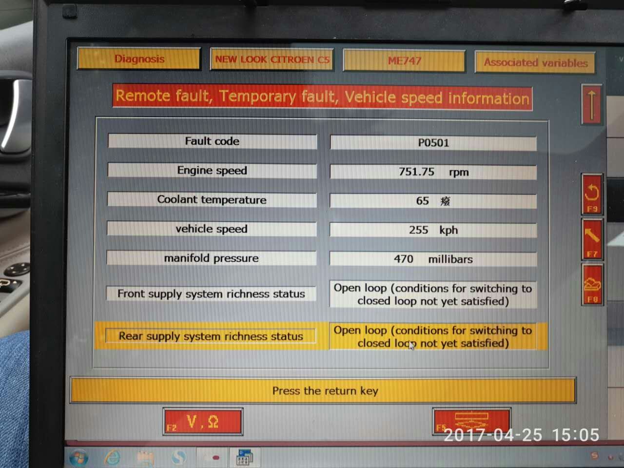

They seem ok. It feels like the torque converter really want to grab / have a lower than factory stall speed. And Lexia shows a fault code where it cannot read the VSS signal. Which seems strange as the speedo works. On Wikipedia it states that this transmission (am 6 / TC 80) goes into neutral to save fuel and to reduce vibration. Is thus true in our Citroen? Would a failure to read the VSS cause the tranny to not know that the car has stopped moving while in Drive? Or is my torque converter bad?

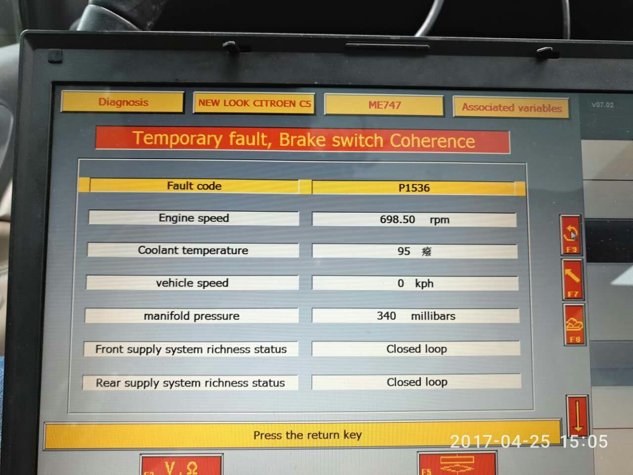

Yes, there is a brake switch fault also. But the brake light does operate. Thus I am baffled as to what that fault means. As the brake light turn on via the brake switch, then why does the ECU/Lexia say there is a fault? Below are the fault codes I currently have.
Thanks.
Thanks.

Modern PSA vehicles have (depending on model and age) either 2 brake switches or a brake switch with 2 sets of contacts. One for the lights and one for the management systems.

Hi. I just edited my last post with the photos of the fault code. Are you saying that if I crawl under the dash there will be two momentary contact switch? I would go check myself but my 2005 C5 II is actually at the repair shop. And if there are two switches, I just check if both are working correctly? Thank you.
