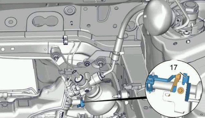

Hi everyone,can some one tell me the location of the front height corrector on a 08 Citroen c5 h3+ suspension ? Thank you

The Front height correctors on the 2.7 and 3.0 V6 engines have one each on each front wheel axle, but if you have the 4 cylinder models then there will only be one of these on the front passenger wheel for a RHD.
This is the close up for the height corrector on a 4 cylinder C5 X7: (click image to zoom)
