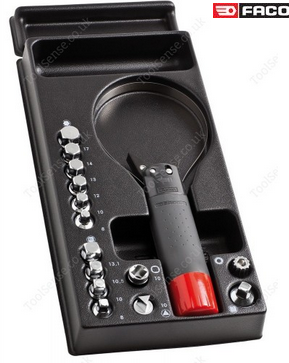

It's recommended that you use one of these - an oil filter wrench. It is very easy to 'thread' the plastic on the top as it hasn't got the leverage to undo the oil filter cover and you may damage it.
https://www.toolsense.co.uk/facom-mod-u ... odule.html
Facom U46CL Oil Wrench
There are of course similar oil wrenches, but this is the one Citroen recommend (I'm not suggesting you buy one at these prices - it's just for reference)!

I have one of those (not Facom but similiar)... never really got great results with it as the oil filter just slips through it :/
Also: Why does it come with so many adapters?
What use does the plastic have then? :o
Maybe I can use both? An oil filter wrench + the plastic cap? But even then, I would need the size of the cap :S
And for tightening the cap I would need a torque wrench? That means it would need to be done via the plastic cap again ?
x 6957
Re: C5 (X7 HDI165) - What wrench size does the engine oil filter cap need?
Those extra bits shown are the various oil sump bits that come with this particular kit (for this sort of investment, it is designed to work on many car models)
I guess that the top part is to be used in conjunction with the wrench, so you don't put too much strain on the plastic nut alone. Also, make sure you replace the seal when replacing the oil filter cartridge.

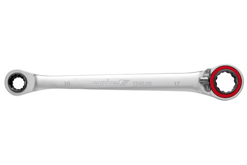

No, a ratchet spanner is not adjustable for size. The central ring will rotate one direction and stops the other way. Like this-

KennyW wrote:Something like this
http://www.ebay.co.uk/itm/PREMIUM-8mm-3 ... KJdVY5H72A
Kenny
kenny is on the right track, I bought one of these and the flexible head helps a lot.
https://goo.gl/vr5S1H
