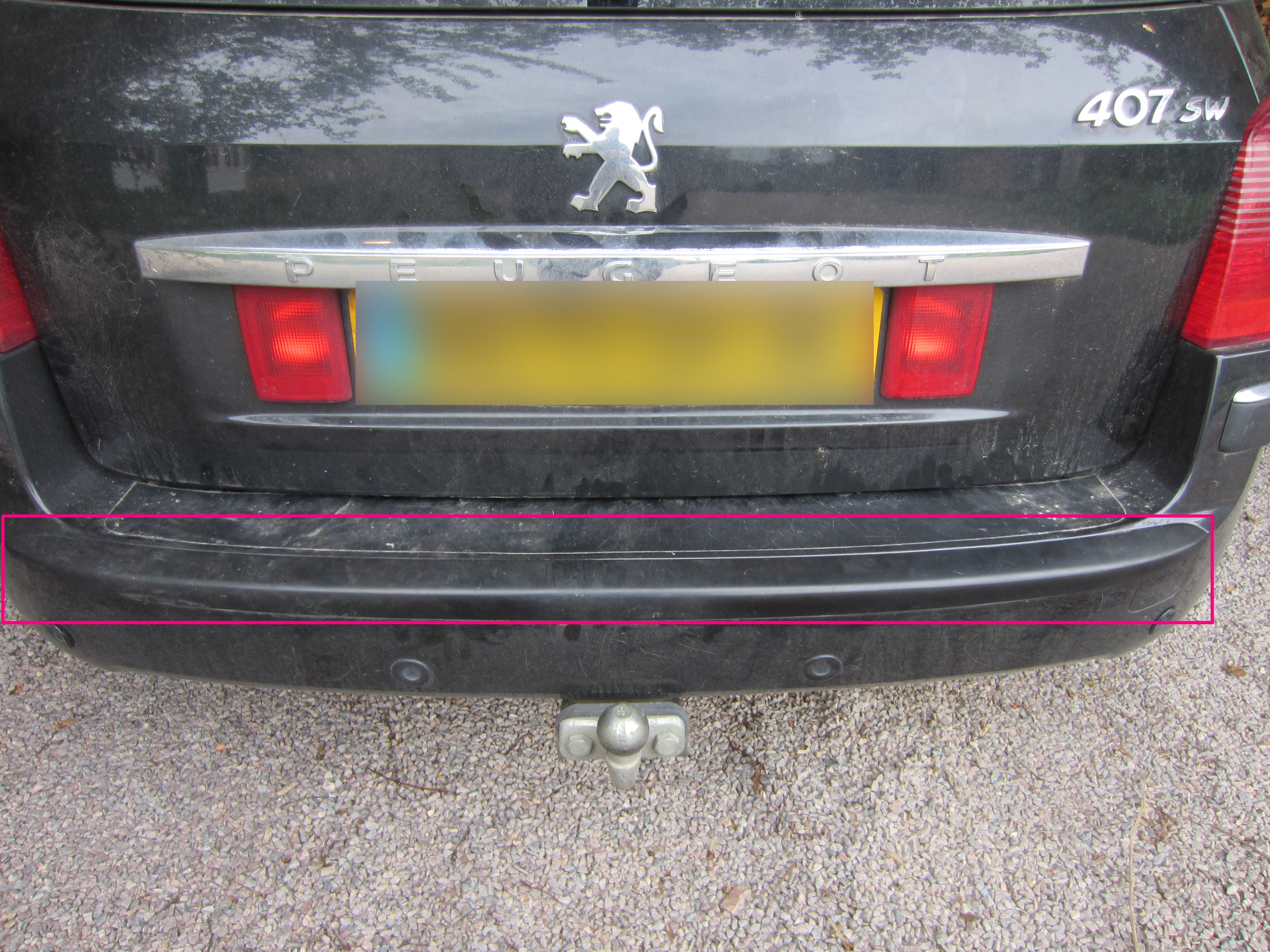

Got a friend with the above car. The rear bumper horizontal protector trim that clips in has broken, probably due to being caught loading and unloading the boot. Does anyone have a part number / rough idea of a price please?
Also a fault has shown up regarding the inside right hand reversing sensor short to earth. Does anyone know how you get them out of the bumper please?

Possibly this piece:
Reference Description Quantity Price - VAT Price + VAT Total + VAT
00007429C9 PROTECTOR 22.63 GBP 27.16 GBP 27.16 GBP
On the C5 sensors are removed from the back of bumper, after you take the bumper off - I imagine the 407 would be similar

Thanks Richard, is that a genuine Peugeot part? I just did a general google with the part number and it didn't show anything. Thanks for the info on the sensors as well. Bumper off, that may have to stay bust for a bit.

Yes, that's the genuine bit. To get a correct price, would need the VIN and a pic showing the exact part needed.

Sorry for the late reply. The VIN is VF3**************[VIN obfuscated, can be read by forum staff]. The car was imported from Belgium to France, if that makes any difference.

Didn't see this as was away...that bit appears to be a bit more expensive:
Reference Description Quantity Price - VAT Price + VAT Total + VAT Selection
00007452AP BMPR RUBBR BOOT 1 41.25 GBP 49.50 GBP 49.50 GBP
The part no I gave earlier is for the flat rubber strip just in front of the piece you have highlighted.
