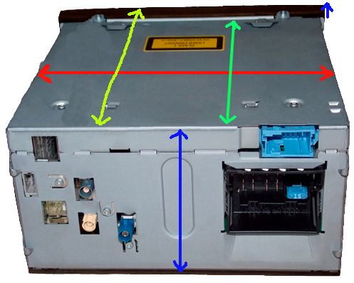

Ok, so I went out this morning and measured as follows:
Red arrow - the width of the metal chassis of the unit is 18cm and 18.7cm if you add in the fascia surround.
Green arrow - the depth is 16.2cm from the rear to the front of the chassis
Yellow arrow - depth is 17.5cm from the rear of the chassis to the front of the fascia surround,
Blue arrow - the height of the chassis is 11.3cm or 12cm if you include the extra height of the front fascia (top to bottom)
I didn't want to unhook all the connections again, but looking at it, there is about an additional 1 mm - 1.5mm of extra space additional to the top and side of the recess to allow the unit to be inserted and removed.
