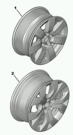

What's your VIN? There were several types of Alloys for the C8 16" 'Douglas" (yes very French isn't it!) was one variation - but these had different part numbers depending on build date. I should be able to tell you the right ones with the VIN.
Actually, there were only 2 types of standard alloys for the C8 the 16" 'Douglas" (1 in the Diagram) and the 16 " "Athena" (2 in the Diagram)
Part No. 5402 P7 for the Douglas
Part No. 5402 V4 for the Athena
The Alloys have the following offset info: 7,00 J16 CH5-27 for both.
I believe the 16" Steel wheel is 7,00 J16 H2 5-27
