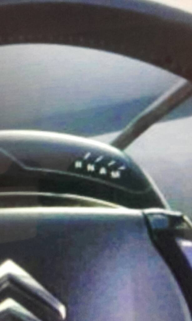

I think they're mostly egs - if there's a pic of the dash, egs has a silver selector above the wiper switch with P n a m r on it.

On every one for sale i am checking the photos carefully. Ive only seen one that has a P on the selector, they mostly have R N A M. Im assuming, probably wrongly, that the one car i have seen with the P has a torque converter auto and the hundreds without have the egs semi auto. Ill go try find photos.

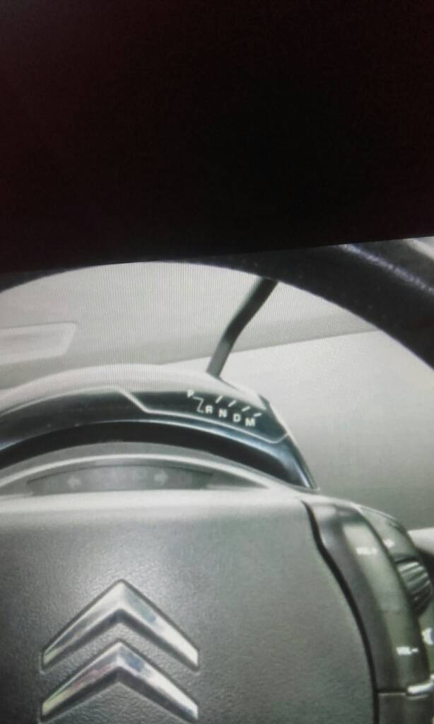

That seems to be what 99% of them have.
I have found one like this, in Glasgow which is a lovely, well equipped low mileage thing but out of my price range. I'm pretty certain this is the fully auto that i would much rather have. I have a thing against the egs after the c2 sensodrive I had a few years ago. The gearbox spoiled that car.

Ive figured out how to tell them apart. Only the 2.0 16v got the fully auto and only some of them. Emissions figures. The egs is 159 and the fully auto is 195. I know that makes dearer road tax for my preferred option, i dont care! One small perk of being registered disabled lol
