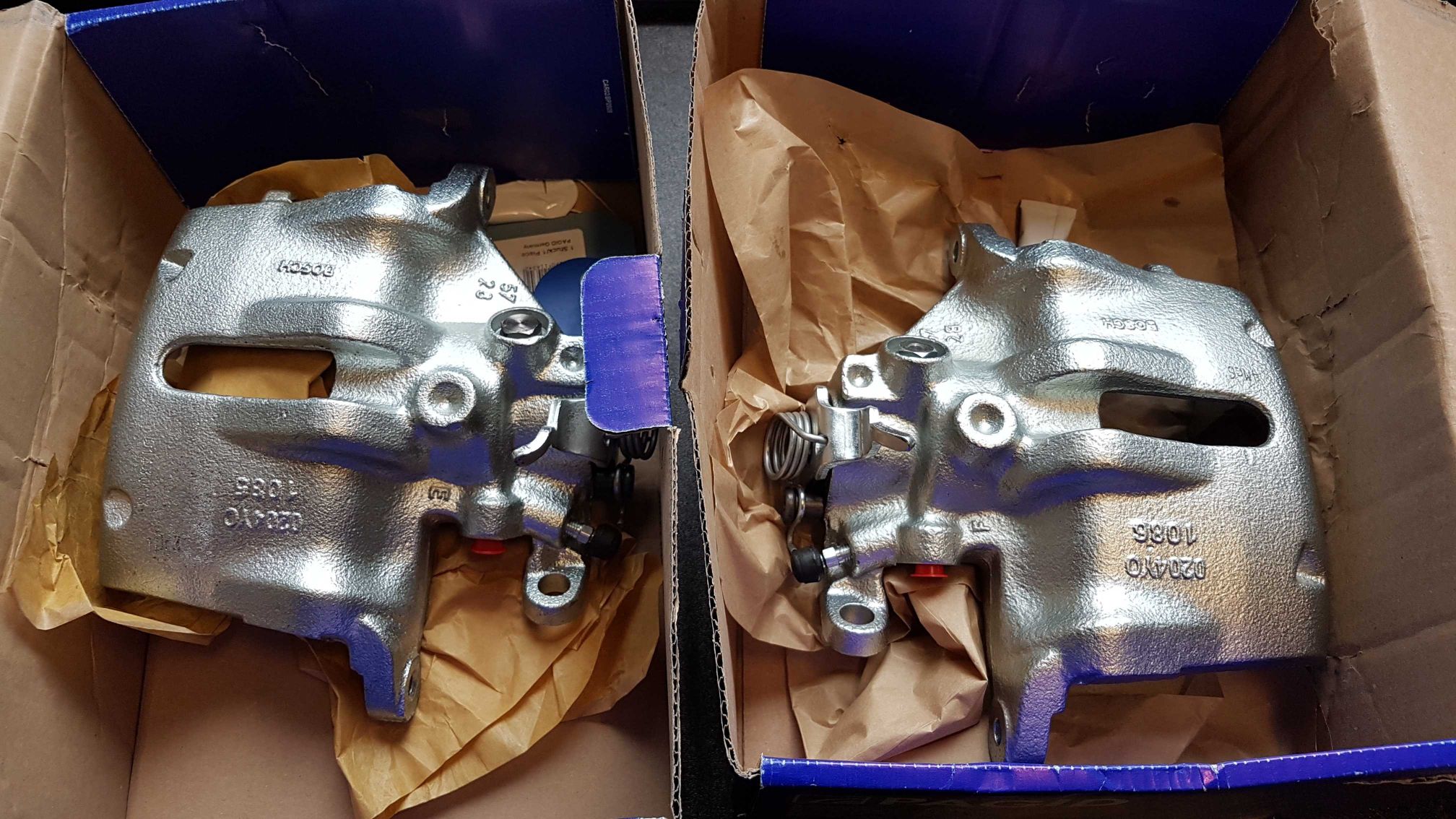

Calipers still sticking guess the cables knackered them.
This will sort it..... £45.99+ vat trade (no vat on these for me).

It won't be the cables that did for your calipers - they seize up for fun, without any provocation.

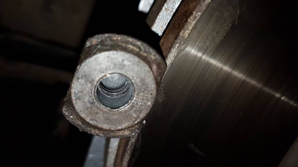

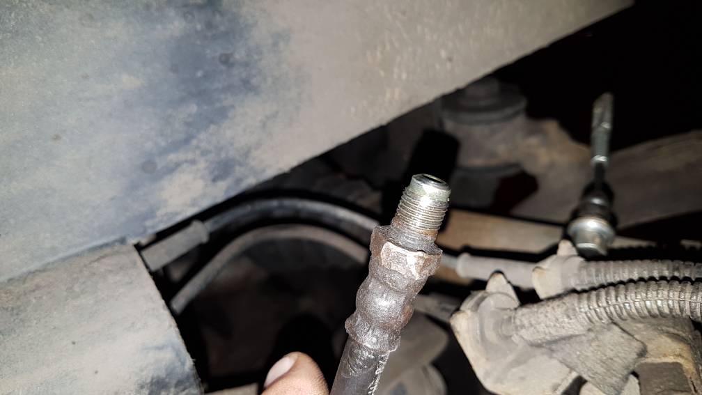

Well that did not got to plan....stopped at work to sort myself.
Brake hose threads stuffed and will not go into new caliper and threads pulled out of slider.
Left at work on the ramp good job I got use of company van as live 20 miles from work.
