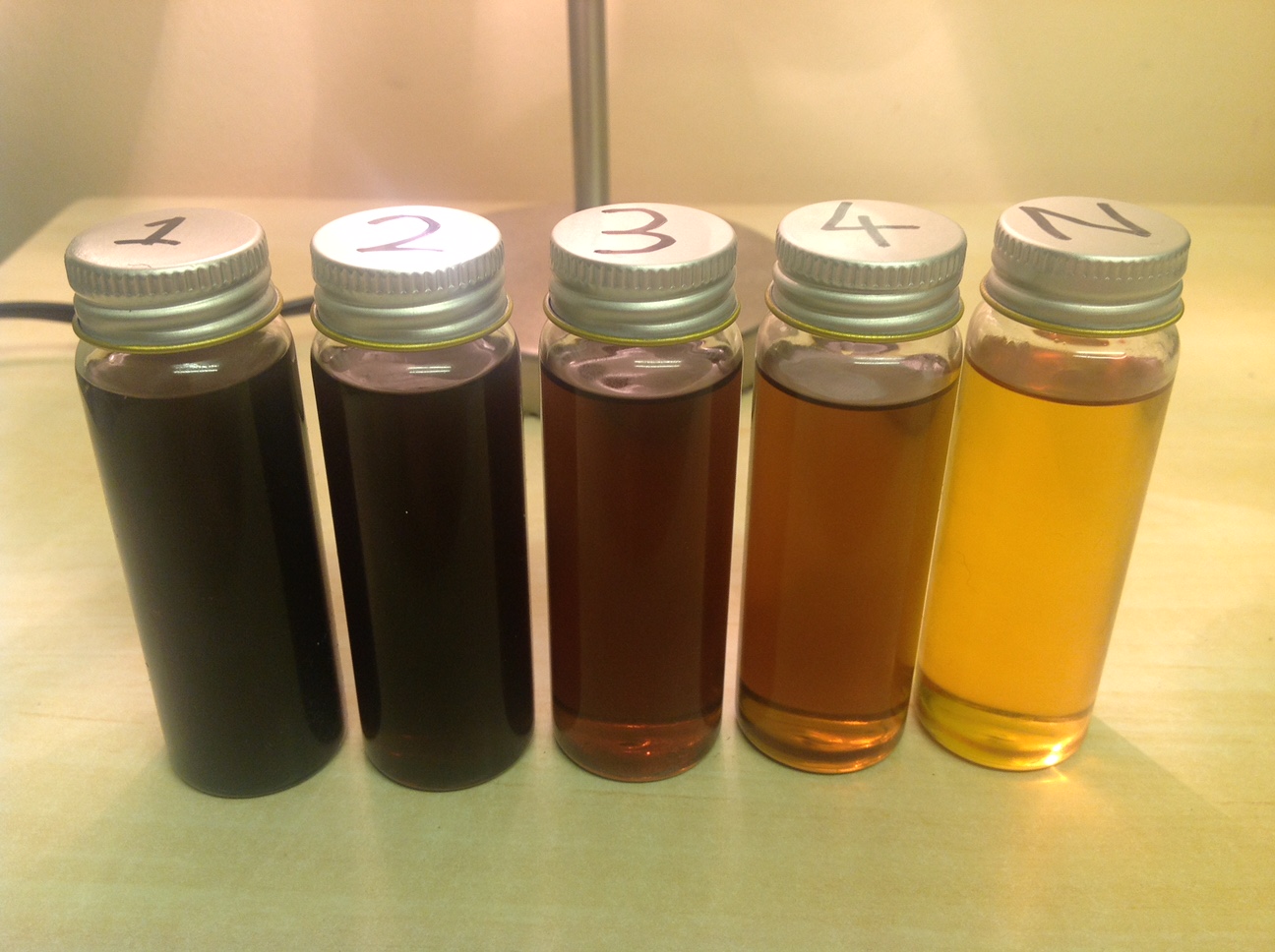

xantia_v6 wrote: 12 Jul 2017, 17:01 If the oil is red, then it is 100% sure that the transmission has been filled with the wrong kind of oil. The correct oil is clear and goes grey, then black when it is old.
New LT71141 is actually a translucent yellow colour and changes gradually to black as it gets contaminated and/or burnt. I've never seen it clear or grey, and I would think grey could only result from particles of aluminium alloy which would not be a good sign... See my picture below where the far right test tube is brand new oil and the others are what drained out of the gearbox of my first Xantia V6 on each successive oil change:
I agree though that if the oil in there is red its the wrong stuff.
You do realise that ZF made the gearbox right ? Why would ZF be wrong and some random oil company be right about whether their oil is compatible ? I would think that oil companies have a vested interest in claiming their oils are compatible with as many gearboxes as possible to sell as much as possible. Without looking at a very detailed specification of the oil you can only take their word for it.teo wrote: 12 Jul 2017, 19:39 Someone (ZF) says wrong ... someone says good ... it's a PetroCanada oil for automatic gerboxes
The 4HP20 and other gearboxes that use LT71141 are well known to not last when using more generic Dexron grade oils - the oils are NOT the same, and have different frictional characteristics due to a different friction modifier package. If you use a standard Dexron II/III oil (which is usually red) in a 4HP20 it will cause harsh/abrupt clutch engagement which will cause rough shifts and other erratic behaviour and eventually cause damage to the gearbox.

Interesting picture Mandrake. So we are going to see here how more milleage can handle 140k miles old 4HP20 on Petro-Canada DURA-DRIVE MV SYNTHETIC. Keep in mind that it was not usual oil drain & refill & repeated few times. It was complete flush&clean with BG machine. I will be checking oil every few months. Rough shifts I can recognize immediatelly but as I said the box have done on this oil 2,5k miles at mostly urban drive and still is quiet and goes very smoothly. Only that tiny RPM drop on 2nd gear....
