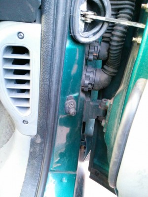

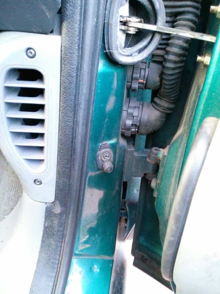

Re: synergie door switches
These are on the front doors.
Yup, mine has them toodemag wrote:IMG_20170306_164818.jpg
Sent from my Wileyfox Swift using Tapatalk
None of them on my front doors !.
