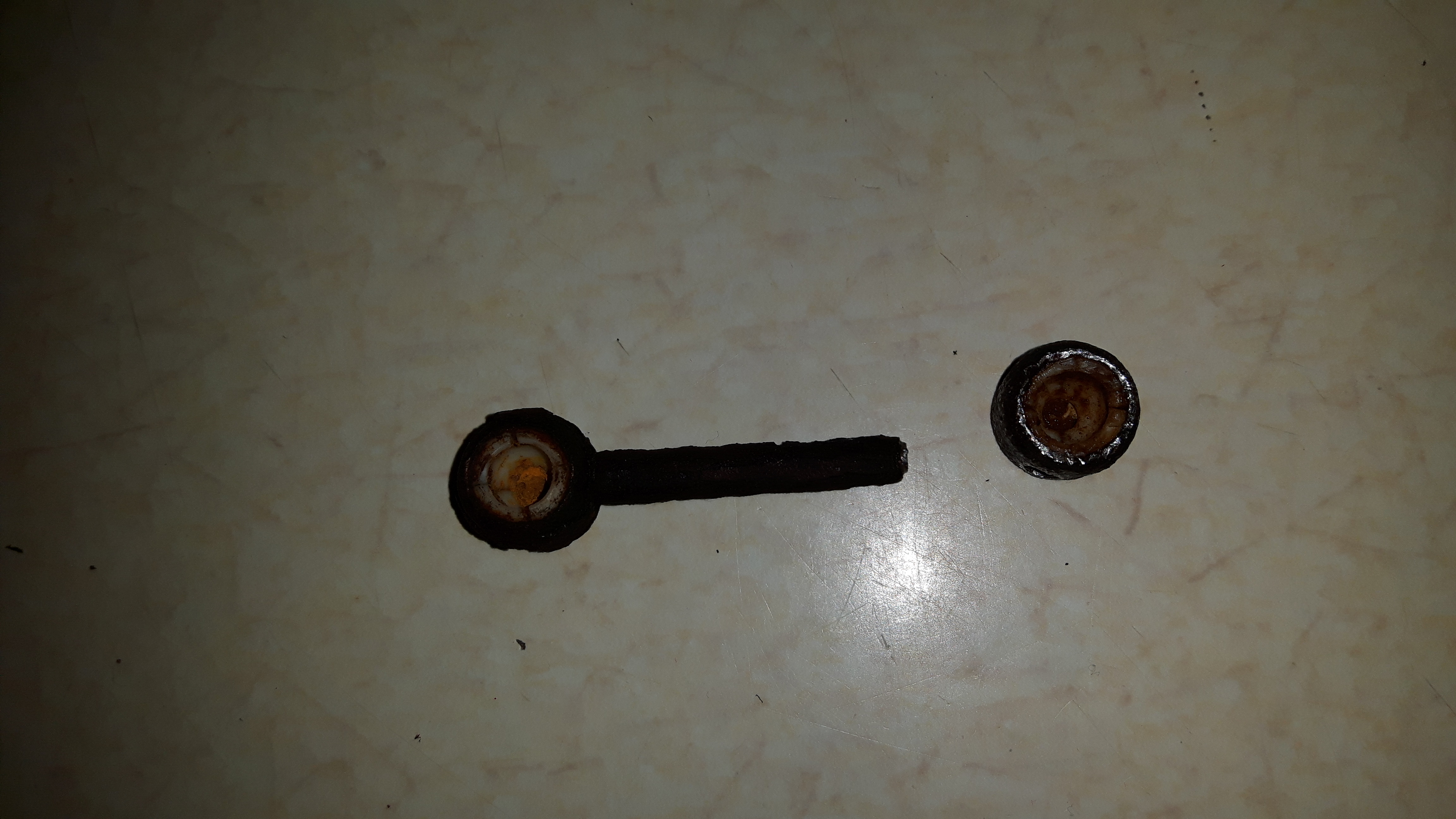

Checked underneath this morning, the thin connecting bar has snapped, anyone ever replaced one and does anyone know the cost? Thanks

From a Dealer, about £20.00.....they "pop" on and off.
WHY has it snapped, rusted ?

If you are going to do this yourself, try not to remove the height corrector or loosen it on the axle by undoing the clamps and moving it, otherwise this will muck up the suspension height references. Otherwise, clean up the area and mark the position clearly.
If it is number 10 in the diagram below, it's the angular pickup and this is £4.79 inc. VAT from Citroen.

Managed to get the pieces off, hopefully I can order the arm without the rest of it!

Head rusted off/broken, exactly what happened to my one.
