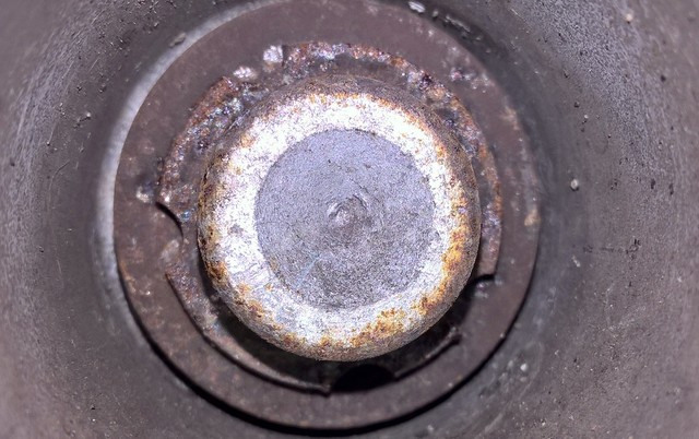

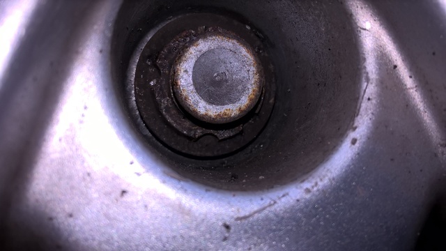

Went to get the alloys off a C4GP and came across the locking wheel nut - nothing unusual there, except there is no adapter! :roll:
There are hundreds of different ones but this one is new on me. Looks like it will have four offset studs inside.
Anyone come across these and can point me in the direction of the correct adapter.

I think that's broken, half of it has been ripped off. my advice would be to go to a good tyre firm and get them to take it off with their special tools.
My local tyre man had all four off my C5 in about ten minutes..............and they went in the bin, they're a bloody nuisance. :shock:

Gibbo2286 wrote:I think that's broken, half of it has been ripped off.
All four are exactly the same.

That looks to me that the locking head has sheared off. I know that you say all four are the same, and that suggests to me that the locking bolts have been put back in by an ignorant gorilla at a bodgit tyre place (either so tightly the heads sheared, or could no longer be undone). I would suggest you take a trip to your local scrappy, and see if they can help. When (on my C5) one bolt (still with the main head attached) wouldn't come loose (and broke the 'key', but fortunately the other three bolts had come out) I believed they could help. In a large bucket in the tyre section they had a large number of 'keys' from all makers, and with various lug combinations. I was able to find a couple that fitted, but (in my case) that did not help (they still got the bolt out though).

The part that's designed to shear off if you try to hammer a socket on it looks like its still there to me, you can actually see it casting a shadow.

If you look at the image I have linked to, you can see that there is a point where the 'head' narrows. It is here that a bolt will shear, as it is not meant to take a socket (it helps keep the 'key' aligned). What I think you have are bolts with the 'head' missing, but with the rest of the bolts remaining;
http://i.ebayimg.com/images/i/281372082 ... -l1000.jpg
This image was found by a Google search for "Citroen Locking Wheel Bolts".

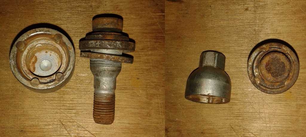

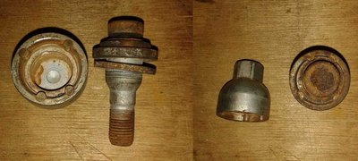

x 3565
Re: Alloy Wheelnut Adapter
What they're supposed to look like....
Own work
Own work

Hmm, lovely, just what I need. :evil: I would tend to go with the tyre monkey ramming them on with the air gun.
Bolt extractor first then . . .
Posts: 14321
x 3298
I think it MIGHT be possible for a 'key' to undo it (if you are lucky), as there appears to be enough for the key to hold onto (but you would want a rattle gun, and a lot of weight on it, to try and shake them loose). Otherwise it may need a specialist.
