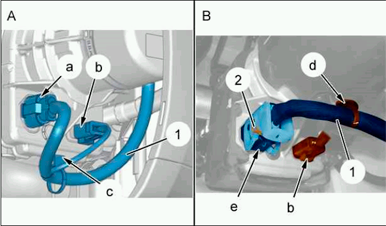

Re: MK3 2008 C5 HDI Tourer Steering issues
It is accessed via the front right wheel once you've removed the wheel and the splash guard protection. You should be able to see it as per the pictures below. I'm assuming you don't have the V6 engine. There are 2 types of wiring harness for the pump the one in 'B' has a split pin.
If it all looks ok visually, with no oil contamination or not loose, I wouldn't take them off or disturb them. Try the bleed first. How old is you battery incidentally? The C5s need a good healthy battery as there is a lot of kit on there to run.
