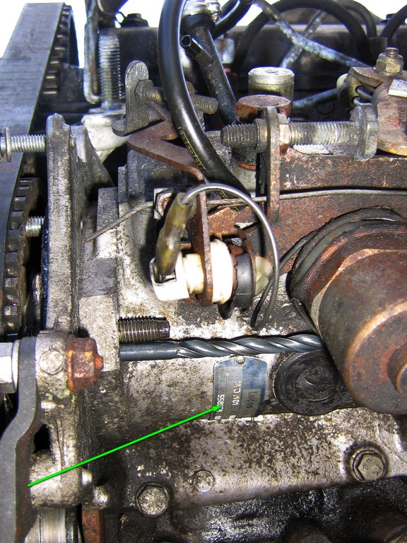

I'm 75% sure this is the Lucas one, but given that my other motor has a turbo, I think even Bosch ones might look different.
Could anyone confirm my suspicion?

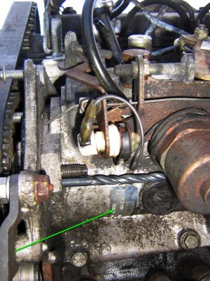

well, it don't look like my Lucas pump (but I'm not used to the Turbo'd engines).
The Lucas pumps have a plate on the underside of 'em, like so, see green arrow towards the bottom of attached pic. Could be hard to see in situ, but you should be able to get a mirror or a small camera / phone / device pointing up under there.

That is a Lucas - an early and very basic DPC.. The location and type of emergency stop lever gives it away... This sort was used extensively on early NA PSA diesels...
The one you show in your picture Pug XUD is a later Lucas with some rudimentary electronic timing control on it... More often found on Turbo engines...

Sucks. Looks like I'll be swapping out Bosch pump from my old dead engine.
