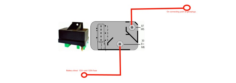

Does anyone knows how the glow relay works exactly. Going to bypass BB00 and BB01.
Is this ok to do?

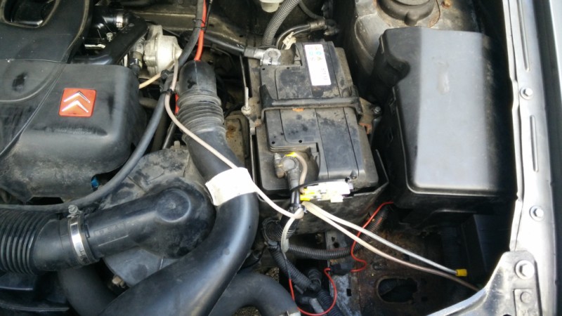

It's working now bypassed the original wiring with my self made wiring (4mm2) direct from battery with 100A fuse to glow relay and to glow plugs.
here is one picture:
Wiring looks tight but, in real a lot of slack.
