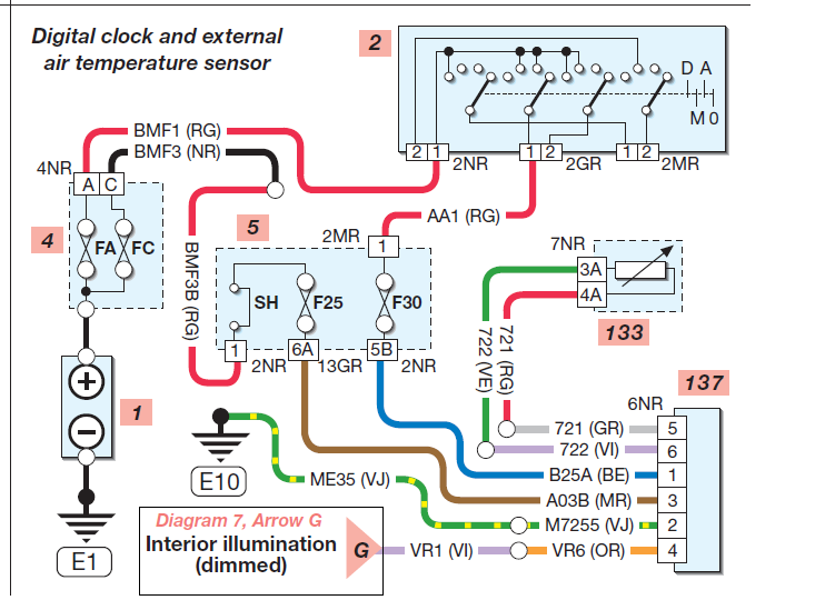

This is the best I have which is for the PhI Xsara. From what you say it looks pretty much the same information as you already have. The two wires from the temp sender enter the display on pins 5 and 6. But, this is for the Ph I, the later might be different.

Thanks for the diagram, the wiring numbering is consistent with the SEDRE diagrams but yours shows some more interesting detail as you can see what each wire is for. The display in the diagram is simple clock & temperature without any bus wiring so as you say there's probably a later diagram. Where is the diagram from?

I can't remember where I got it from in its pdf form but it matches, page for page, the wiring diagrams in my Haynes book for the PhI Xsara. The only difference is that the pdf is in colour.
Can you confirm, or not, whether your setup uses a 6 pin connection? I have a horrible feeling that the PhII Xsara has more pins as it can display information for doors open, etc.
