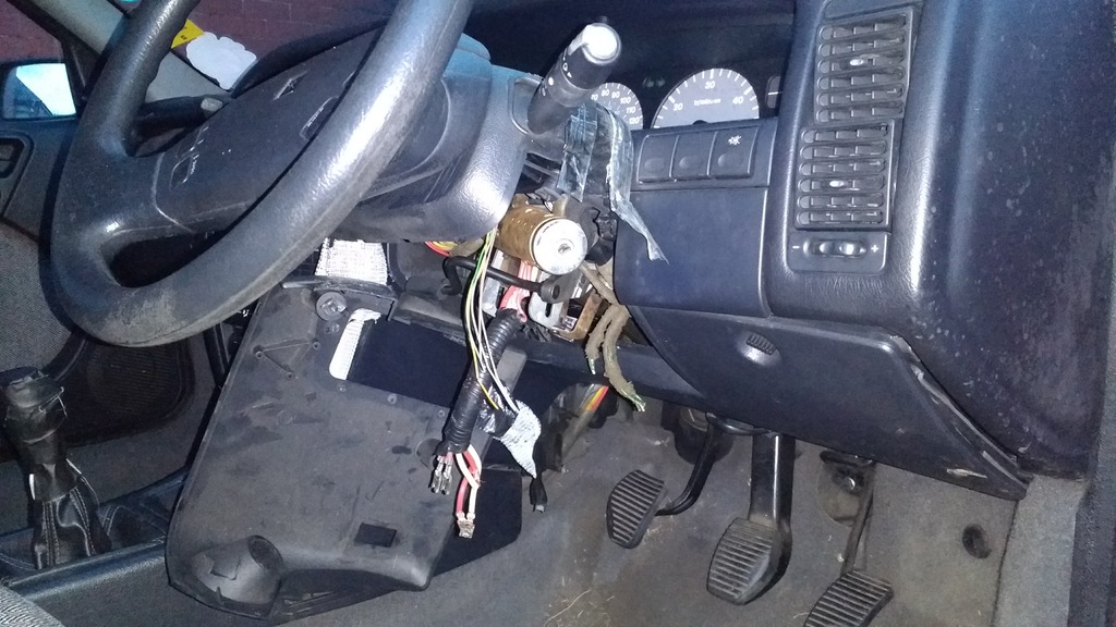

So I had intended to drive to work in it today, but last night I found this mess!
Gutted, what a state. I don't even know where to start with those wires!! :(

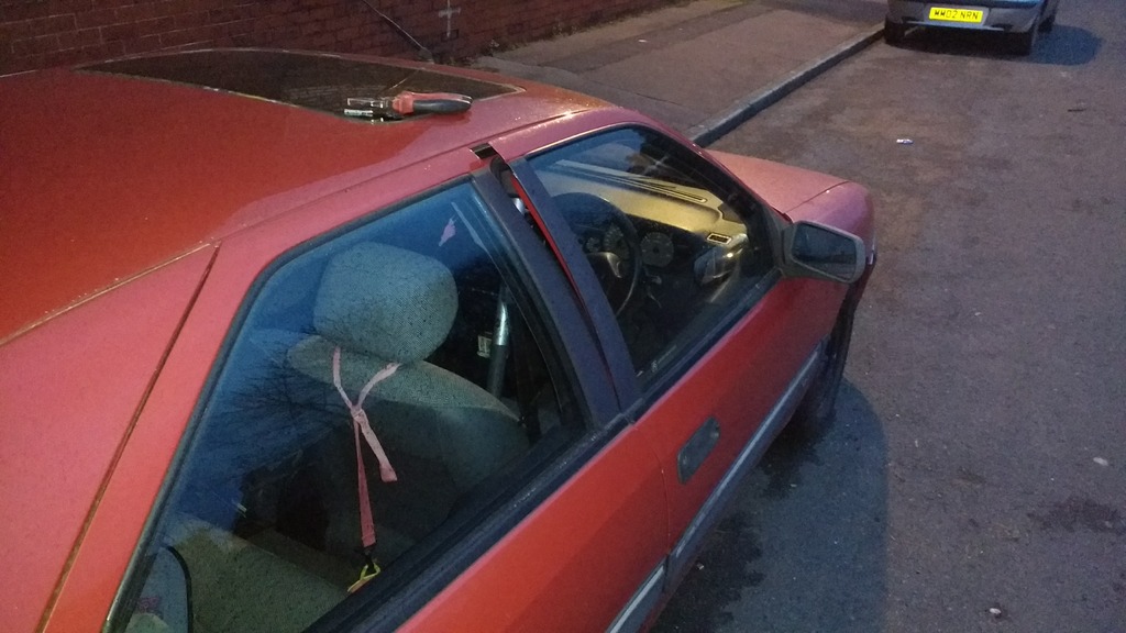

the door is bent back and it's secured again.
They even mashed up the steering (Thatcham stop lock type device) lock Barrel. and messed with ignition barrel so the Key is tight.

Sorry to hear about the robbing scum though, on the wiring front it looks like they've just ripped the wires out of the switch so if you can find a replacement barrel/switch and key it'd likely all just bolt on and plug in. I wonder if they got it started but then couldn't defeat the steering lock? (PSA locks are a lot tougher than contemporary fords/rovers/Vaux etc, I learned that when I lost the key to my 205 and then bent the steering wheel pretty shapes trying to move it out of the road... and again when I pulled the same trick with my 405, i never even tried to snap it on that lol i just drilled/chiselled the barrel out to unlock the steering and joined the wires with a hidden switch...)

I don't know why they bothered. last attempted theft was 6 or 7 years ago, bent passenger door, pushed around the corner after destroying teh steering top bush and left it there, this time via the drivers door they've really messed with the cables. I was too late to take a close look last night, there are two brown plugs on the floor, maybe I just need to faff with it. I had a Thatcham 3 Halfords steering look baton on there (second pic visable). I even live near a security firm! Wouldn't have been much of a joy ride thats for sure and diesel on the empty light. I'd only just recharged the battery too (previously flat)!

I'm having a look at this now. In the wire pictures I can just about guess the big wires from.ignition barrel I think but I can't yet see where those thin ones with foam on have come from. Hoping the 6 barrel ones are all I need...

Ignition wires from barrel. Two red shortest I've made the brown socket, doesn't seem to matter which way round. The middle length red and white are plugged in to grey. And the longest white and red are plugged in to the black.
The engine starts but settings are wrong it starts on second click of ignition but have to turn all the way and hold to switch off the starter motor. Hmm I've tried a few different swaps of cables but no joy. Hellllp

Haynes BoL doesn't show me wiring colours at a quick glance, but the black plug should have pin 1 as the permanent battery live & is the main supply into the switch.
The other wire (pin 2) of the black plug is the starter supply wire, (if you can take the wires all back out again and then find your permanent live, you can then touch each of the other wires to it quickly and see which turns the starter over, then that should be the black plug sorted.
Brown, I'm not 100% but seem to recall that being the blower fan connector and possessing 2 red wires. Pin 1 on the grey plug appears to deal with battery charging and should bring on the batt light with the key in position 1. Pin 2 of the grey plug should supply the rest of the stuff like glow plugs, lights,. wipers etc when the switch is in position 2 (run).
Hope you're able to extract something useful from that lot.

Thanks that's perfect it's running again. Turns out long and medium needed to be swapped. Messed with wires now it starts. Just need better connectors now.
