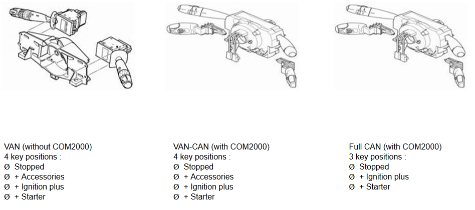

I'm looking to retro fit some aftermarket reverse sensors to my C8 (2006 reg) as it does not have any.
Looking on line, some suppliers are claiming that the C8 is 'can-bus' and therefore needs a kit which is can-bus compliant, and some suppliers make no mention of it !
Anybody have an idea as to which is right, i.e is the C8 can-bus or not ?
Thanks in advance.

Ok, so the C8 came in a CAN / VAN and full CAN version later on. The way to tell is from the following picture (click and it will zoom up). Which of the stalk configurations do you have and also how many ignition key settings do you have - this will tell you what you have.

Thanks for the quick reply,
Turns out mine is full canbus as only three stages on the ignition.
My thought with an aftermarket sensor kit was to wire it into the reverse light but i'm thinking that a 'non canbus' kit would upset the system or am I wrong.

The wiring systems really need to be CAN friendly in this case otherwise they can upset the signals being sent along the multiplexed network and hence other systems on the same network may be affected. Try and find a CAN enabled one first.
