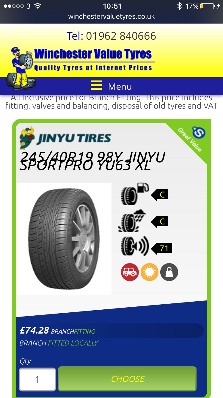

Best value tyres I can find were £75 fitted
Had two of them put on the front when I first got the car
Sent from my iPhone using Tapatalk
