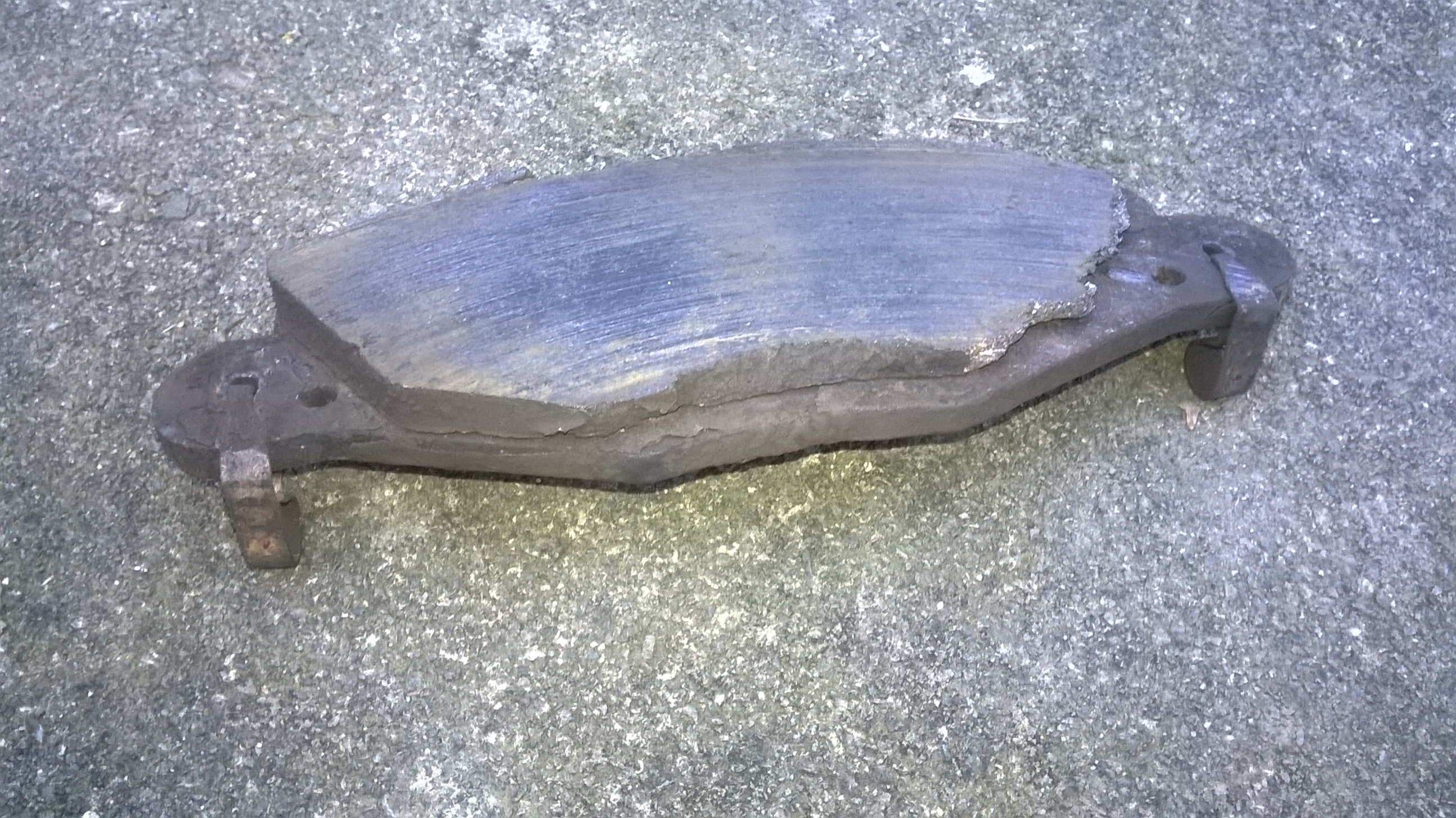

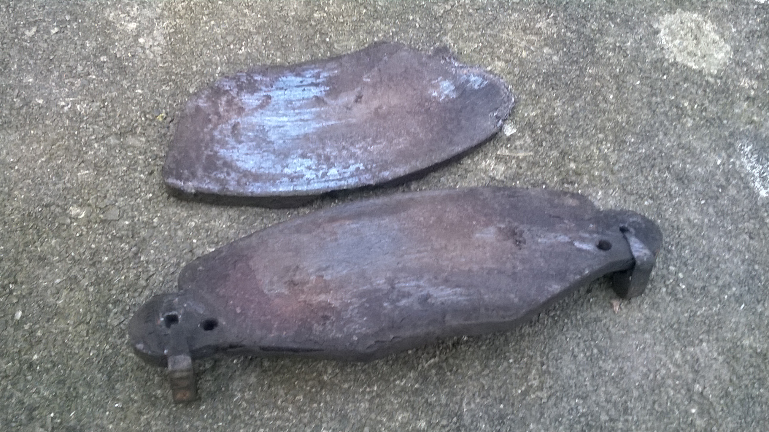

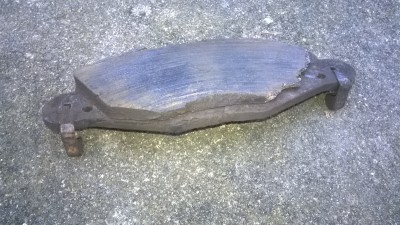

Thought I had the dreaded handbrake / caliper sticking issue, but no -
(C5 Mk1) Front passenger side, inboard pad. The pad has come away from the backing, could move forwards but would wedge in place to stop reverse.
Anyone had this before?
New type of reverse only handbrake.

Age and/or overheating due to sticking caliper

Sticking caliper - thats what I was afraid it was, I've got some new pads on their way tomorrow, I'll see how it goes.

It is always the inside first, it gets all the kerb side rubbish and puddles thrown at it.

Nail on the head! Thanks.
Drivers side was the same, ie inside pad material had come away from the backing plate. Caliper all covered on crud too.
That pad plate shows signs of overheating - paint all bubbled up and layering off. I've put it more down to the build up, as the handbrake cables move freely, the mechanism moves and easily goes back to its stop. Pad still have plenty of meat on.
New pads and cleaned up.
I'll keep an eye on.
