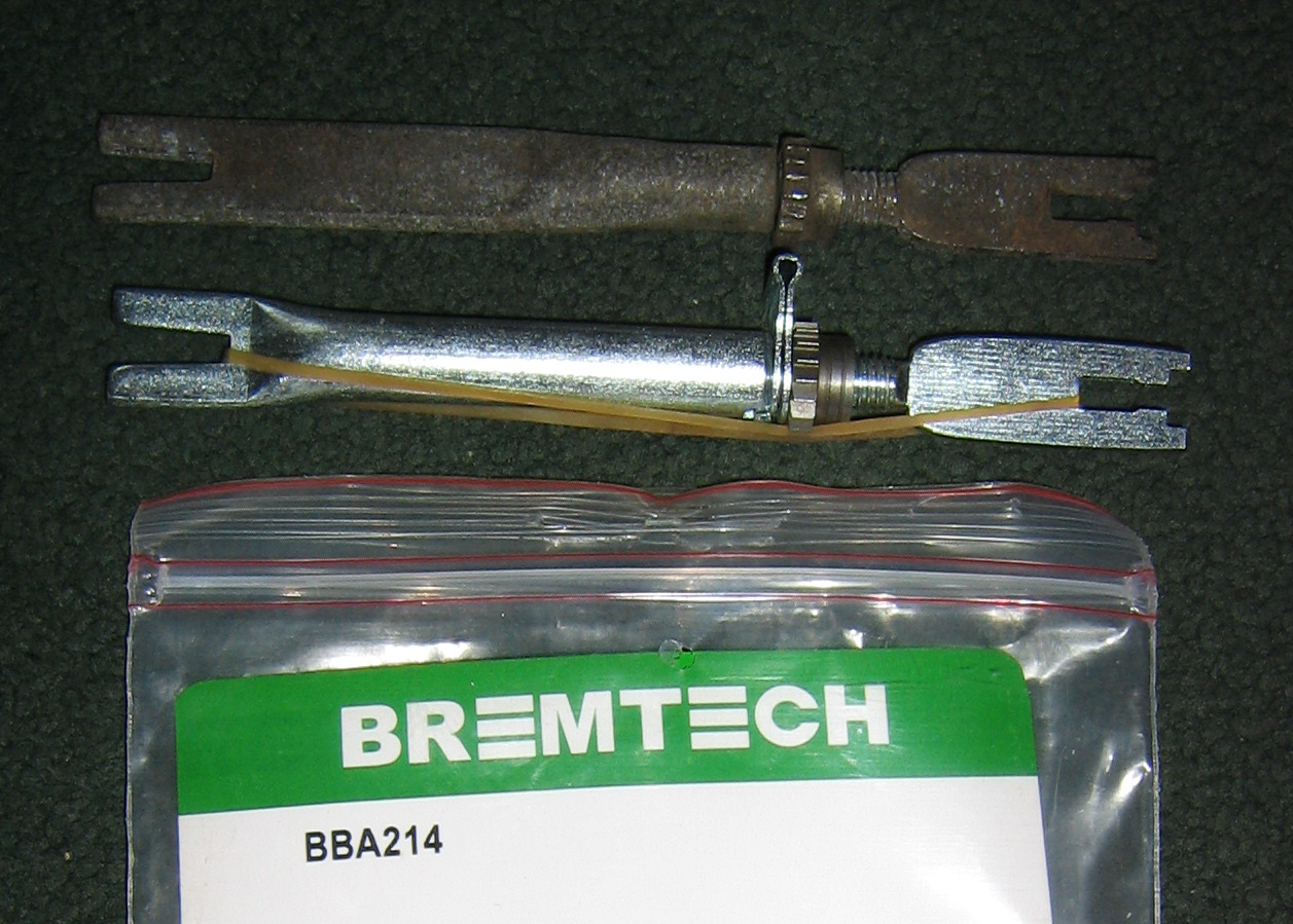

following an MOT failure on 'Rear Brake Imbalance' among other things, I decided I needed a new set of adjusters
So having worked out that my shoes are the LS1233 type (Lucas with Roll Pin as opposed to without)
I then realised I couldn't find any adjusters anywhere
So cross-referencing the list of other cars those shoes are used on (Delphi online Catalogue) against Ebay, I deduced that the BMW E30 Adjusters are the same. Sorted !!
Just a tip :-D
