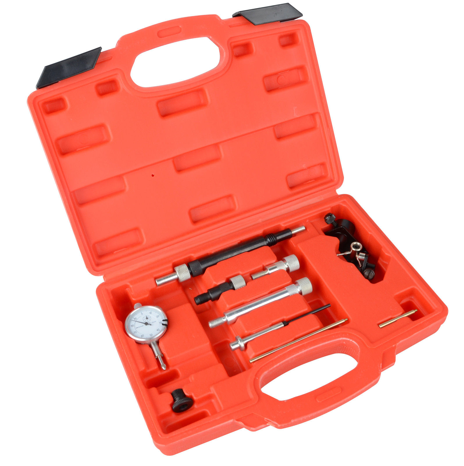

Has anyone bought something similar to this and used it successfully on the Lucas Cav Rotodiesel (Pug 405 XUD in this case)
http://www.ebay.co.uk/itm/New-Diesel-Fu ... Sw9GhYlC3m
I timed up my pump roughly about 2 or 3 months ago following issues well documented elsewhere on this forum. Starting is on the button as usual, performance is better than ever, but idle is a touch rough and the throttle lever does nowt in the first half of its travel
...so I'm tempted to lay out a couple of quid on something that'll allow me to do it accurately in accordance with the method printed in the BoL (anyone know whether that method works as Haynes claims?)* before I start messing with the idle screw.

I did this once but made up my own tools on the lathe to work with a DTI on a magnetic base. It worked well..
I no longer have what I did as the parts I made got recycled into something else... Special tools for Activa roll corrector linkages....
I will say that if you have access to a lathe it's not hard to make up what you need.
