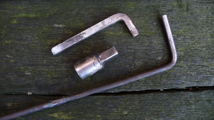

With the help of a telescopic mirror I could see that my spring tensioner pulley was of the type that had an arm with a square hole in it - Haynes said this was to be used with a ratchet/bar to push the spring back, but could only be accessed with the belt off - but I could get to mine with the belt on! (perhaps the old belt was so stretched?). The square end of a 3/8" socket extension bar should fit in this hole, but I didn't have one of the right length, so had to make one by welding a short piece of 10mm square bar into an old cheap socket, total length about 1 3/4".
I also made 2 other simple tools for the job: a 7mm square key for the manual tensioner (made from an 8mm square door handle link bar with ~1" bent 90 deg and filed to 7mm square) and; a 6mm pin to lock the tensioner - just a ~12" length of 6mm round bar with 2" of it bent at 90 deg.

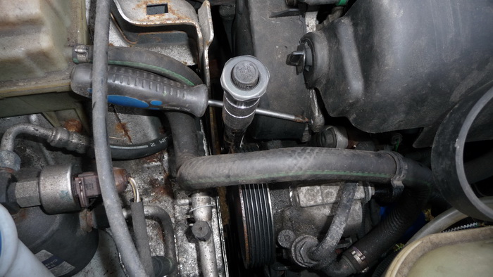

From above, I got the square socket in place (not something you can see, just have to feel for it), and wound it towards the front of the car to push the spring back. Unfortunately I couldn't get the 6mm holes lined up despite several attempts. So got round this by locking the ratchet in its furthest position with a screwdriver (see photo). This was all I needed to get on and remove and replace the belt (6pk1750).

photo 2: simple tools I made up for the job
photo 1: ratchet (using a torque wrench because it was longer) pulled back and locked in place with screwdriver against body and timing belt cover (belt was removed before photo was taken).
