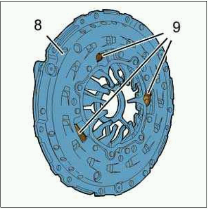

The clutch is hydraulic on your car and has automatic wear adjustment Nigel.

Re: 2007 Mk2 Citroen C5 clutch pedal travel.
Hello Marc,
can you elaborate briefly please? how does the adjustment work?
is there any way to gauge its wear? other than a strip down?
Im thinking about having a Duck clutch fitted.
Thanks
Nigel.

On your car it should have an original LUK Clutch - and the automatic play adjustment mechanism is (8) in the diagram and the compensation springs (9).
I updated my last post above regarding some DMF advice too.

My thought about DMFs is that heat kills them - so do not hold it on the clutch any longer than absolutely necessary. Our C4 needed a new clutch at 90k as the release bearing exploded - so no sitting with the clutch down either. My 307 is on original (AFAIK) clutch and DMF at 125k.....
As Marc says the 2.0 16V HDi has a self adjusting clutch and hydraulic actuator, so pedal position will give no clue as to wear state of the clutch. I helped my mate change one of these, and it's not a lot of fun! His had done about 90k - the clutch was still in reasonable shape with plenty of wear left, but the DMF was toast - so much slop that the flywheel part was wearing the outer cover, and a great pile of metal dust fell out of it when we took it off. The original LUK clutch / DMF is not cheap - no idea how much the conversion would cost to Duck clutch - is a full new clutch kit required, or just a retrofit of a new actuator?
