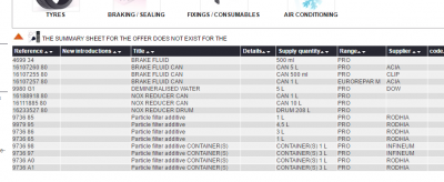

Doe anyone know how to find out which fluid the car is supposed to use ? When I look in servicebox with the chassis number it shows four items, all Rhodia. There are two 1 litre quantities, a 3 litre and a 4.5 ! I can PM chassis number if you can help me.
I'm assuming the 1 litre items below are the fitting kit (tubes connectors and overflow bottle), but I don't understand why there are two 1 litre options and two 3 litre options there too !

If you look under the fuel section you should be able to find it - I think my 307 (07. 1.6 HDi) is fitted with a bag. If you post up the VIN I'll have a look.

Ah, tank not a bag, so that's no help! If you look at post 6 on this thread: https://www.frenchcarforum.co.uk/forum/ ... =3&t=50195 there is info from Citroen, I would imagine Pug is the same. Your RP is 10183, so should have originally been 176, now discontinued, so you can use Powerflex of Infinieum - record which in case you want to add more later! Or you can use the generic PATS fluid.
