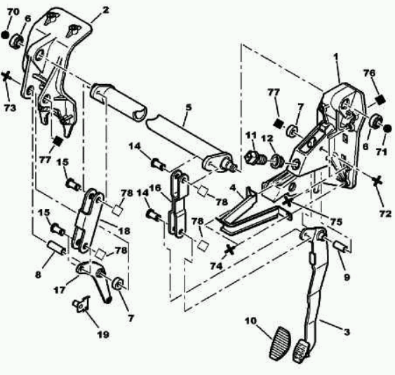

PM sent Kev, but posted here for the benefit of other members too.
Here's the diagram - Part 11 is the Brake Switch and this is Part Number 4534 52.
The price is £10.91 plus or £13.09 inc. VAT from Citroen.
