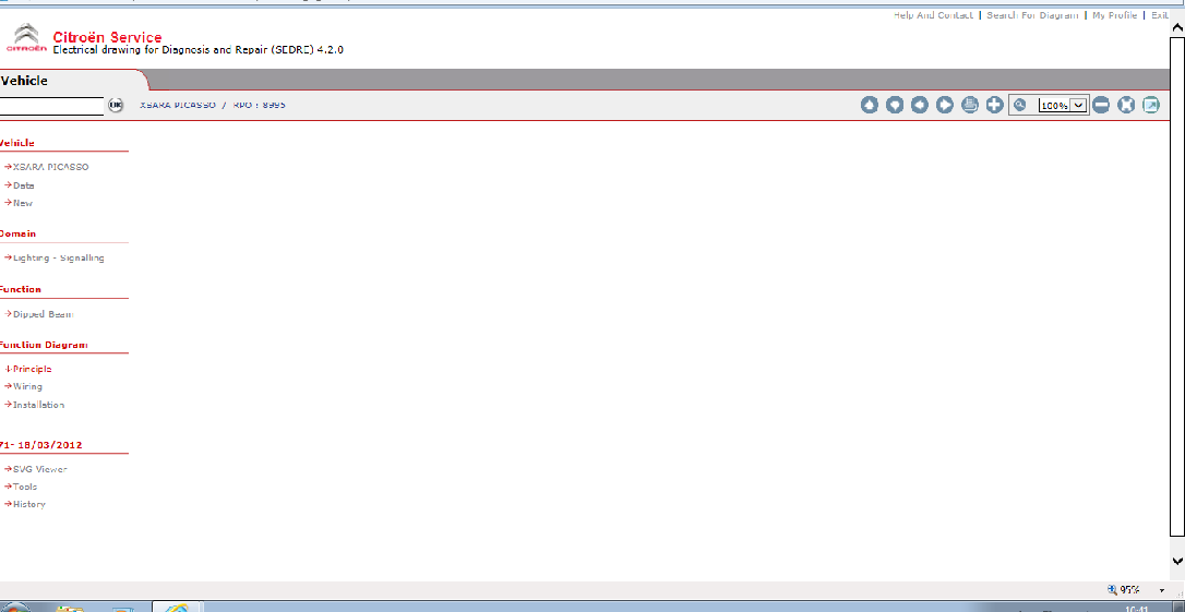

This is what im getting. There is also a blank pop up that appears when I open SEDRE, I have allowed pop ups & it makes no difference if I close the pop up or not.

It's fussy about the browser as they changed some software components in IE 11 and later that it doesn't like. I have it running on a Windows 7 Ultimate Virtual Machine under Windows 10 Pro 64 Bit, but I have it running under IE 9,
- x 6950
Re: SEDRE on windows 7 64 bit
I completely forgot to say, you will need to install the 32 bit version of the IE9 browser as SEDRE will always open a new instance of the default system browser and it does not like the 64 bit version at all.
