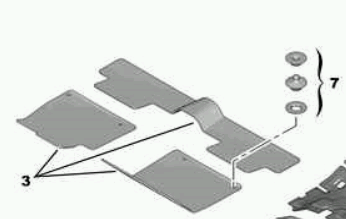

I have Citroen C5 X7 2012 and one floor mate clip (male one) has been broken and i have bought the new one but i dont know how to fit it in the car floor. Do i need to remove floor carpet to fit the male clip. And does anybody know where i can download workshop manual to se how to remove floor to fit it thanks.

It would seem that the fixing kit (7) just consists of a bottom clip that goes under the carpet and then the nipple snaps into this. There are no detailed instructions on this I'm afraid - apart form the diagram below. You may be able to lever off the middle part shown in the diagram from the carpet and snap the new one in place.
