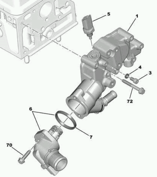

These have an electric thermostat, which I'm sure has come up before as giving problems. Could be worth sticking a new one in, to see if it fixes things. Little bit pricey from Citroen....
Part Number Description Quantity Price excl. VAT Price incl. VAT Total incl. VAT Selection
00001336Z2 THERMO FITTING 48.44 GBP 58.13 GBP 58.13 GBP

Here's the part Richard is referring to: Part 6

I had the opportunity to have a quick look at the car last night and yes as mentioned it does have the additional sensor on the thermostat housing located on the underside. Having never heard of such a thing I didn't notice it there, especially with the connection loom being hidden by the top hose, anyway I picked up a new one from my dealer yesterday and intend to fit it at some point this weekend, will report back once done.

Update on this issue, I fitted the new thermostat yesterday and then did a diagnostic session, whereas previously the fault was shown as permanent and wouldn't clear, with the new thermostat fitted the fault now showed as temporary then allowed me to clear it completely so hopefully it's now sorted.
I'll get the Dremel out at some point and section the housing to show how this sensor/electric thermostat works.
