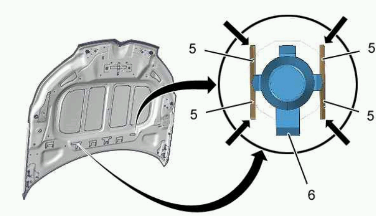

Re: C5 x7 screen washers.
It seems that it's not very easy to remove nozzles from the hood, and install new ones. Any tips on this?
- x 6956
Here's a diagram:
You push back the tabs shown at (5) that lock the jets in place then you can remove it.
