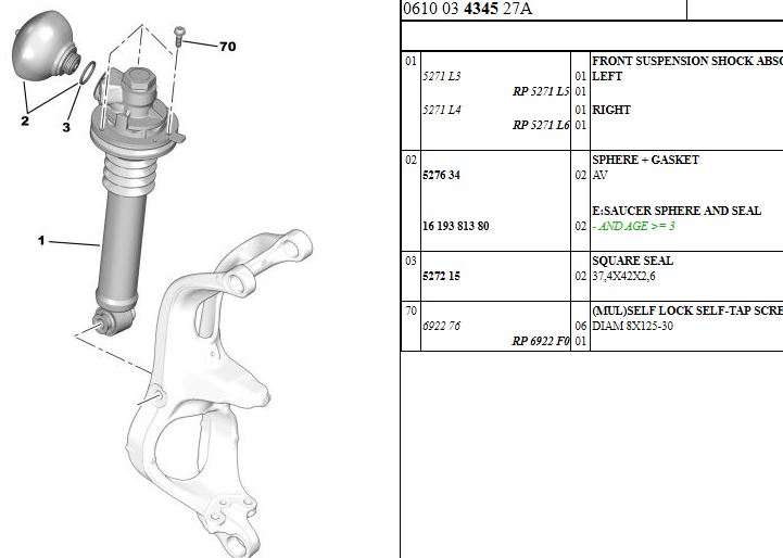

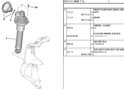

The car is a 2009 Tourer exclusive, so it has Hydractive III+. The front passenger side (car is LHD) knocks when I go over a pothole - only a small one will do it - and I was also aware of a leak in that same corner, from the top of the suspension leg.
The knocking comes from the bush that is inside part of the suspension leg. The mechanic showed me and said the hydraulic oil leaking onto the bush had probably caused it to fail.
Here's the rub. The bush is not available as a separate part - it's all in the suspension casting and has to be replaced as a unit. €339 part, €158 labour (2.8hours at €56/hour).
He says no chance to repair the oil leak in the leg. The suspension leg, fitted, will be €430.

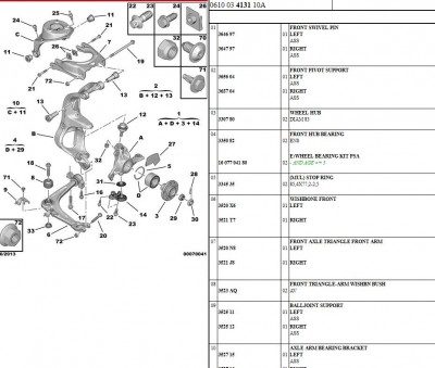

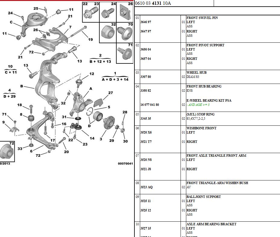

I guess he means '1' for the suspension leg.
It's the bush at the bottom of 'B'.

I have found and ordered a bush, so it's just a matter now of finding a suspension leg from (maybe) a damaged car?

Can you be more precise about the location of the leak? Is it from the bellows, or higher up?

Seems to be from the very top (when you look up inside the wheelarch, that's how it looks).

Have they been lifting the car off the ground without the LDS cap removed ?

Still here, still undecided. I got the bush that is for the bottom of the arm 'B' but the garage will not fit it. Warranty, etc. So I will have to find an independent.
Has anyone removed the old bush and pressed a new one into this leg 'B'? Indeed, is it going to be difficult to get the leg 'B' out?
I don't know if anyone else has lifted the car, wheels hanging, without taking off the LDS cap. Certainly I have (ashamed, didn't know) but the leak was there when I bought the car so it wan't me, guv. Or at least, not all me.
Since I like the car so much and want to keep it, I guess I'm just gonna have to pay up for the shocker and it's fitting. But I hope I can do the bush myself.

I would not rebuild it without replacing the lower joint (14), these wear and I wonder if it is worth trying to refit it anyway considering you have the lower apart for the strut anyway.
