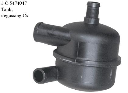

As a forum newbie I'm hoping someone here can help me. The de-gassing tank (part of the cooling system) that sits up to the right and behind the V6 engine on my S2
XM has sprung a leak and I'm having serious problems :( finding a replacement. The part number is 1307HJ and I gather it's also fitted to V6 Xantias – a pic is enclosed. Does anyone know where I might buy a NOS or good (i.e. pressure tested) s/hand item from a scrapper, anywhere in Europe? (BTW, I'm going to Paris in early Feb so could collect if relevant).

I think that part number is 1307GF (for Peugeot) which I think is still avaliable. Xantia has different angles where the pipes are connected to the tank (part nu. 1307HJ).

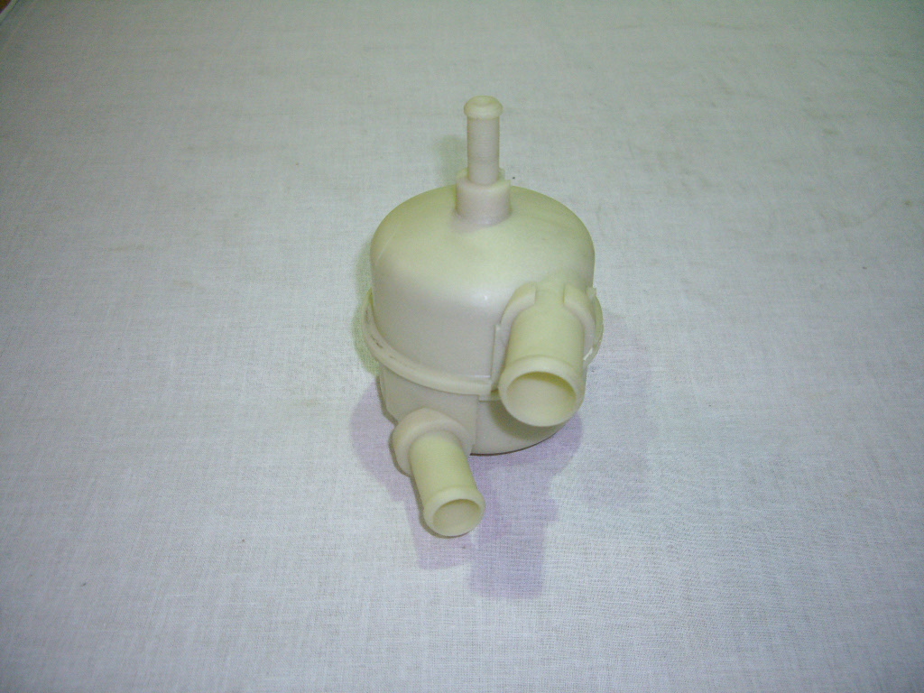

I managed to source a NOS Peugeot-numbered part from the ever helpful Malcolm at Savoy Garage (in Burnley) but not only do the lower two pipes emerge at different angles, but the top one is of a wider diameter and is shorter than the Citroen part. Making adapters to fit the hoses to these would be tricky and in the case of the latter, almost impossible due to its retaining lip. :( See encl. pic.

@markysimon: The black one is for Citroen, the white one is for Peugeot. So if you can get the black one that's the right one! I can check the diameters at home as I have one on the bench (and probably Stickyfinger has at least one stored somewhere :-D )

xantos wrote:@markysimon: The black one is for Citroen, the white one is for Peugeot. So if you can get the black one that's the right one! I can check the diameters at home as I have one on the bench (and probably Stickyfinger has at least one stored somewhere :-D )
Thank you Xantos, but I can assure you that the (off!) white one is what was on the car when I bought it seven years ago! And the hoses fit it perfectly. Although the pic I posted of the black one is appended with the legend 'Cx' – suggesting that it's off the XM's predecessor – Malcom Orme assures me its a Peugeot item. :(

xantos wrote:Then probably owner before you has already changed it. Peugot ones (the one you have) are still available as far as I know...
Well that is mighty weird, because the 1307 HJ (Citroen) part no. shows a pic of the white tank on the websites that refer to it.

Citroen ones have always been white to my knowledge and the differing pipe angles on the Peugeot one may mean it won't fit...
