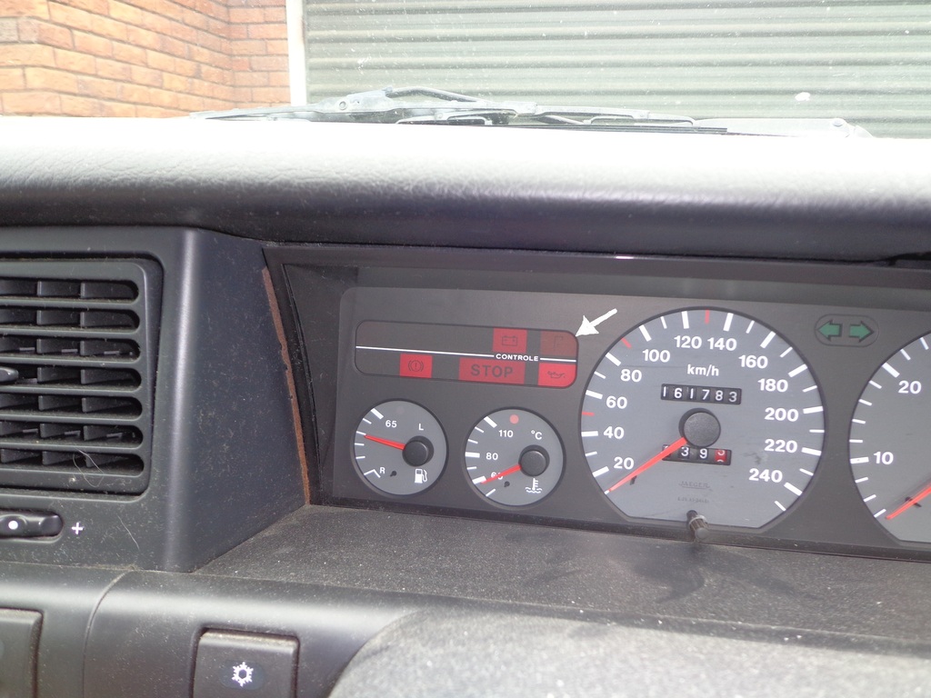

Dumb question but what is this orange warning light on the dash of my 93 Xantia ? Sometimes if flashes on start up , it was actually flashing when I took the pic Image

Engine Oil level.
It can be very unreliable and 'cry wolf' a lot, especially if you use very modern high-tech synthetic oils.

On my first Xantia, the level warning light would flash sometimes, even when the level was correct, but an oil change would put it out for a few months.

xantia_v6 wrote:On my first Xantia, the level warning light would flash sometimes, even when the level was correct, but an oil change would put it out for a few months.
Mine often does on my Activa, especially after a hot start...
Gabriel very rarely lights hers so I wonder if there may be a subtle difference between the S1 and the S2...

Yes nearly always does it when hot. Thanks guys :)

My V6 ALWAYS flashes its light after a short run, it does not have to go far and will on restart flash away without fail.
I HATE it, it is the only thing that dislike about the car..

The Green Lady rarely flashes her 'Low Oil' light, it's genuinely a bit low (around half) which the sensor takes exception to if she's been started parked nose down on a slope - in which case it will go out within a few seconds. I hadn't noticed that oil changes make any difference, perhaps because it's always been my habit to carefully top-off the oil level after a service and she used to take around 5,000 miles to consume the 2-300ml needed to start the sensor playing games.

My beloved Xantia S2 Estate used to cry wolf with that oil level light too, parking with two wheels up on a kerb was enough to set it flashing even though the dipstick would reveal all to be normal, the current S2 HDI does not do this.
