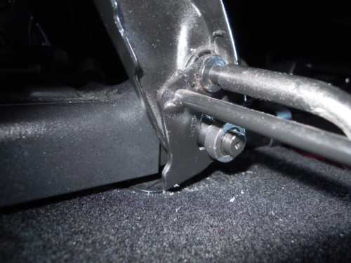

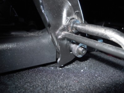

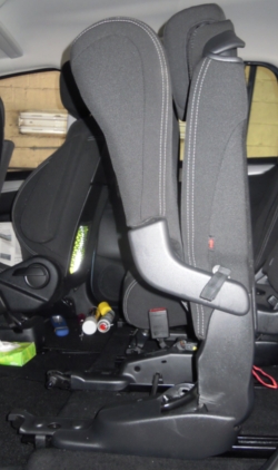

In full daylight (and not being rained on!), the cause was fairly obvious; on both 2nd row outside seats, some numpty at the dealer had forced the seat squab down when the seat wasn't in the reqired position. In fairness, the Handbook is both vague and downright wrong on two counts: it states "handle E under the seat.", when there is no handle under the seat, it's where the illustration shows it, on the top outside corner of the seat back! If the instructions for "Repositioning" the seat are followed, the seat WILL be jammed with one of the latches jammed on the wrong side of its latching peg: -

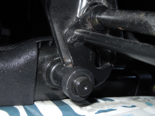

As a result, the latch mechanism is jammed solid with the latch on the other side engaged. The jammed latch should be latched like this: -

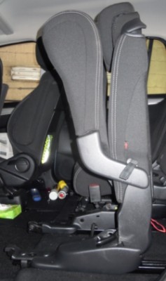

The remedy was slightly brutal: with a big engineer's screwdriver, I levered the jammed leg upwards from the peg while gently pulling up on the handle E (as per Handbook) - sudden bang and the seat squab flew up, the backrest tilts forward into the Cinema Seat position: -

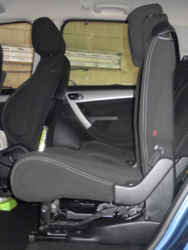

In this position, the whole seat will freely slide forwards against the back of the front seat to provide access to the two third row seats.
"REPOSITIONING" the seat for normal use:
BEFORE attempting to latch the squab back into the sitting position, the seat must be in the cinema position with the backrest fully upright (as above).

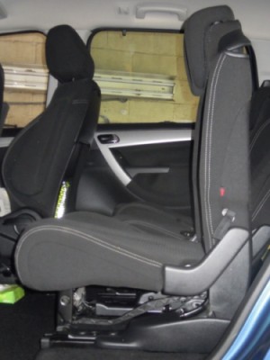

Push the seat squab down against the spring - a gentle thump with the flat of the hand on the front edge of the seat may be needed to make sure both latches are fully engaged. The seat then looks like this: - The whole seat can now be slid back into the desired position, where it will latch into the slides as soon as the back-rest is tilted backwards into the normal sitting position. The seat now slides and tilts normally.
If the seat squab won't latch easily, you're doing something wrong - if you try to force it, you'll end up jamming and/or damaging the seat!
