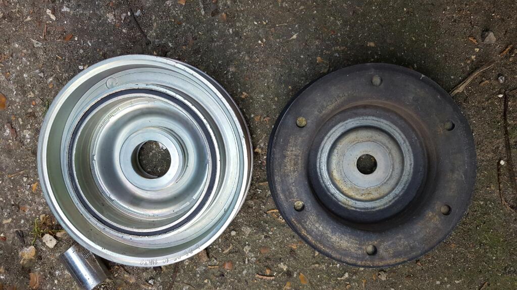

Anybody know the part number for the pulley ? I've looked on servicebox, and it shows 0515.v9. I have one of these in original cit/pug wrapping and it is not right. The 0515.v9 pulley has a hole in the middle of around 30mm with a key slot. The one that I eventually took off the car (man that bolt is tight) has a hole around 12mm diameter and no keyway.
Anyway - I'm after one of the pulleys with the smaller hole in. Needless to say, almost all the secondhand pulleys on ebay are like the one I want, and every new one I can see a picture of is like the one with a large hole. All help appreciated !

Here's the picture. Guess which is which !

Had a chat with a guy in Pug cambridge recently, and he's telling me that the crank angle disc behind the pulley has been changed, and the new disc will provide location for the new pulley. He wasn't 100% sure though, and didn't have the disc in stock. Its coming up to needing a timing belt, so that will be the test - can I get the disc off to access the timing belt without damaging it....

I hate to say it, but Pug were right ! The new crank angle disc is a lightweight thin thing rather than the older style with a boss in the middle on the crankshaft. Part numbers can be dug out of services if needed.
