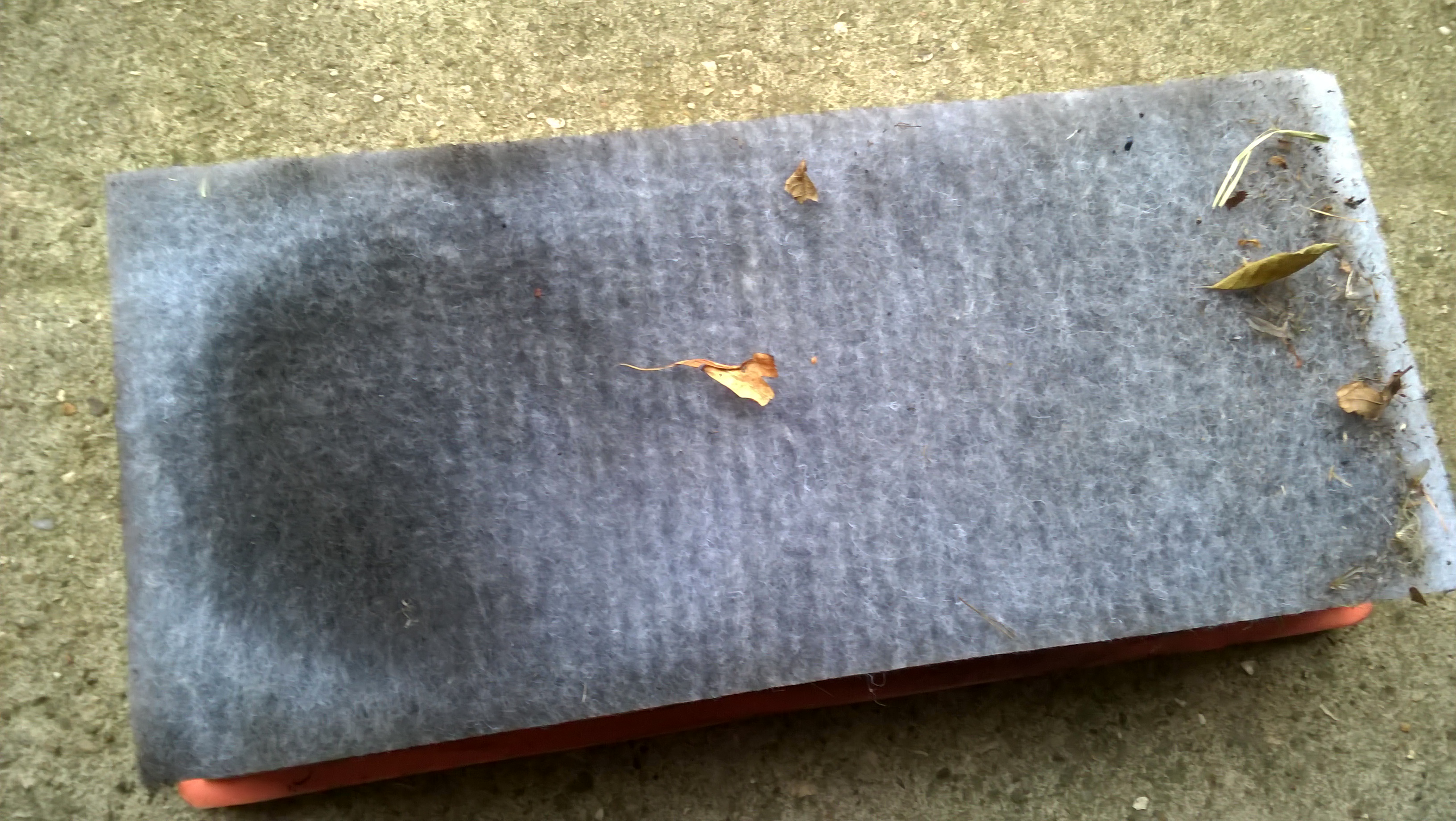

I bought a set of filters yesterday, intending to service the car this weekend...air filter included, just for the sake of it. On removing the old filter, I found this -
....and the bottom of the airbox was full of dead leaves, twigs and some sort of sandy soil, amongst other things! :shock:

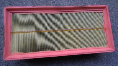

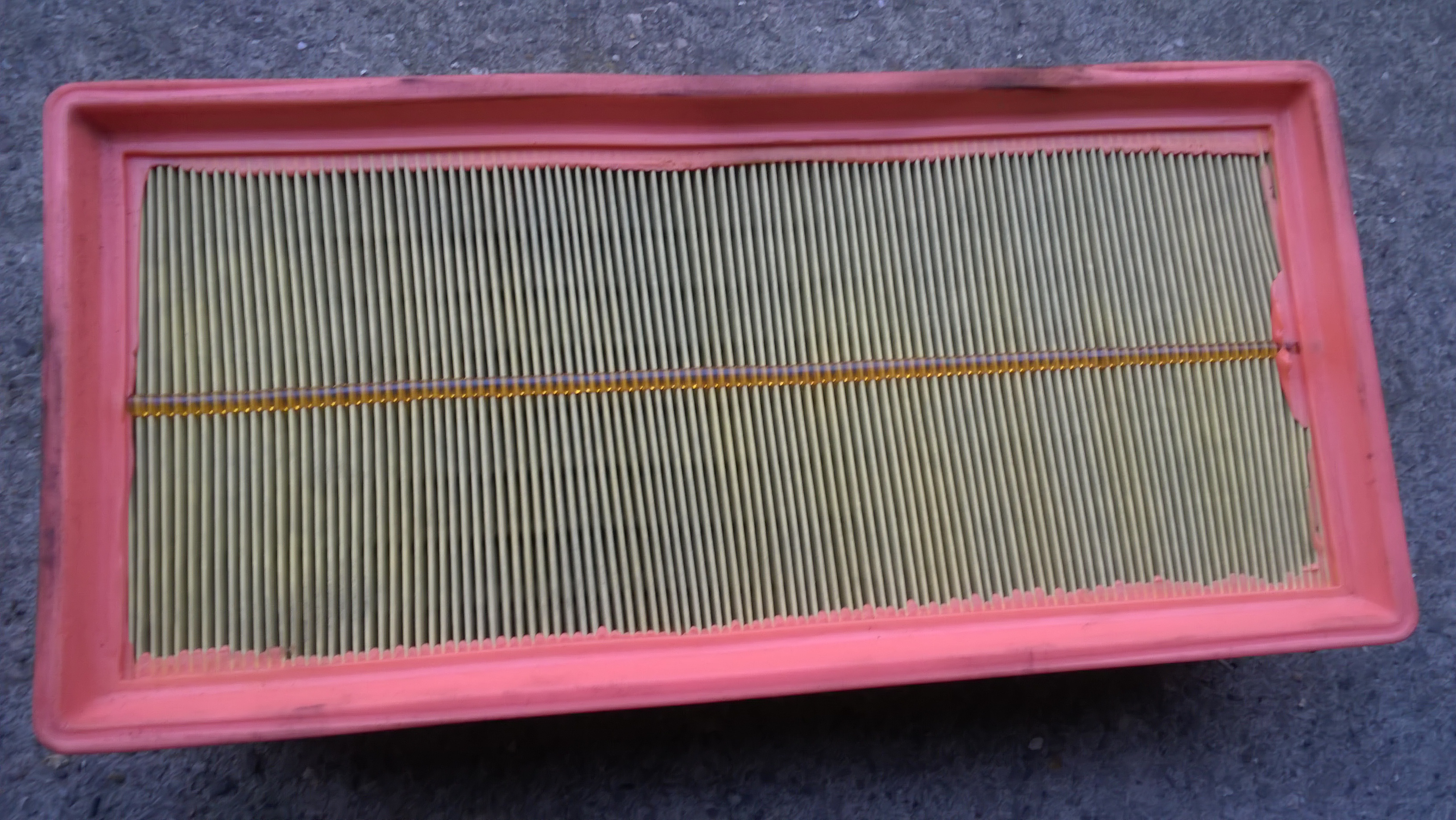

Not at all surprised by the leaves, twigs, grit and crud under the filter. That all looks pretty normal.
What is a bit of a surprise is to see what looks like a large white flat cotton pad covering the bottom of the filter element. Usually the underside is deeply concertina'd, to maximise the surface area presented to the upcoming air flow. A flat surface is very unusual. Has someone laid a sheet of cotton pad in there to keep the paper filter clean? This limited surface area would be expected to clog up much more quickly.

The filter with a pad is a heavy duty version. Underneath the pad is the standard convoluted filter.

The one I took out was a Crosland....the replacement one was coincidentally the same (via ECP) and came with the same pad on the bottom.

The pad is there to filter off larger items and should last slightly longer than a filter without the pad.

That makes sense, it has got quite an open 'weave' to it.

Some of the aftermarket ones (the 406 is the same actually in this regard) do not have the extra 'foam' area they just have the normal pleated type paper.
I suspect this is because the filter type itself is very very similar to the XUD ones fitted in some vehicles...

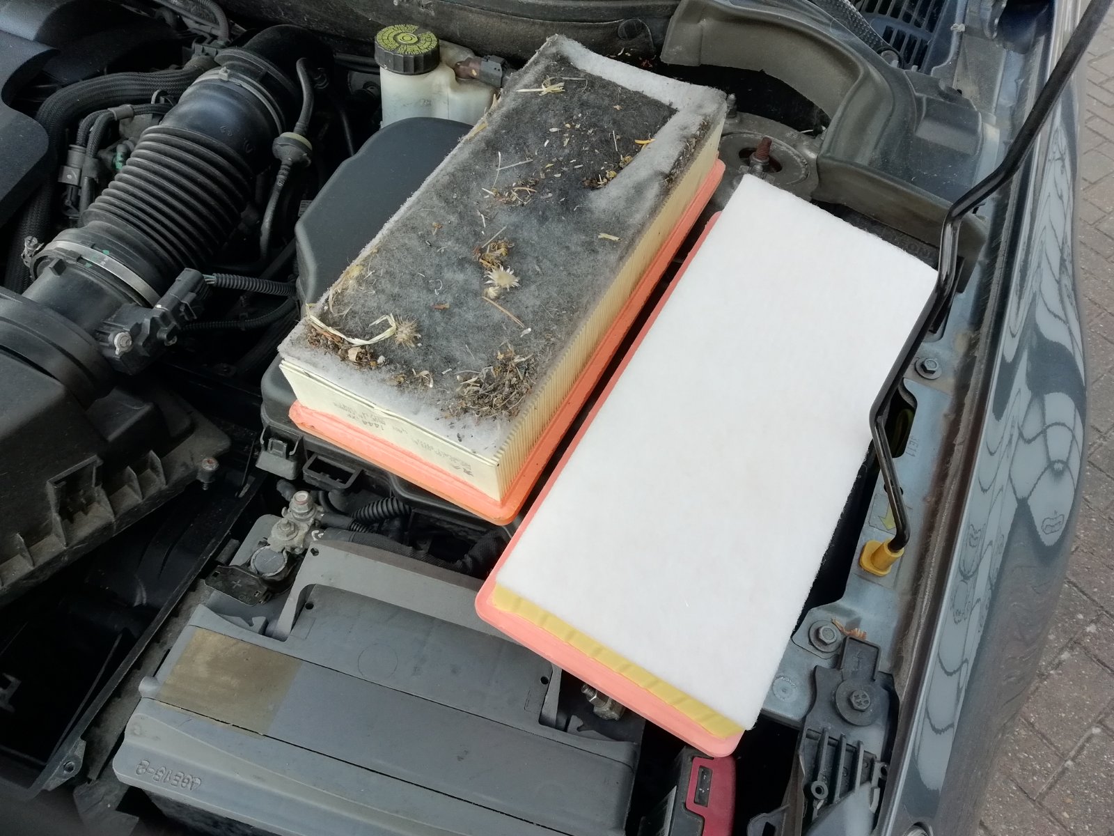

I know this topic is nearly a year old but I changed my air filter this morning. I recall someone just a few weeks ago saying he'd removed his air filter to improve the running of his engine. Not a good idea! This filter has done around 12000 miles.
They are not very visible but amongst the crud there's five wasps, a couple of thistle heads and loads of grass seeds. There's an equal amount of rubbish in the bottom of the box. The new filter is alongside.
