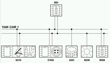

From what you are describing, we have several suspects and it is not going to be very easy to diagnose electrically because it is intermittent.
There are several possibilities, it could be the BSM engine fuse box which may have a broken solder joint / dodgy connector - as this is linked to the BSI and the COMMS 2000 unit under the steering wheel. The BSI and the Comms2000 unit both transmit information on this specific vehicle via the VAN 1 network as shown below: As you can see the CV00 is the Comms 2000 unit, 5001 the rain sensor, 8038 the sunlight sensor and BSM is the Engine Fuse Box. These are linked to the BSI via the VAN 1 network.
The difficulty you have is in determining if this is a faulty Comms 2000 unit or the BSM engine fuse box / connection between them. If it is a solder joint, the cold weather may contract the break causing the problems to be more noticeable, but when it is warmer and the joint expands - it may become less frequent.
Regarding the Comms 2000 unit, is the indicator stalk slightly loose or wobbly? Usually, these are quite rigid and have no free play when gently moving. If the stalk is slightly loose and can be moved about, this could be causing the problems within this unit (fogs, headlights and main beam all on the same switch) - so I would still consider the comms 2000 unit the prime suspect - but due to the randomness of the problem (another comms 2000 characteristic) it would be hard to nail it with certainty. All I can tell you is that our dipped lights were going on and off on their own, main beam was sometimes not working, and the headlights would randomly switch off and on at night. We have the auto lights system - which again is handled by the comms unit. Sometimes switching to manual worked for a while but the problem got worse. A replacement comms unit cured everything.

Sounds like its complicated the matter! The stalk feels, and looks like new. the van has a full service history from new but can't find any mention of them being replaced. As the van has done 271k there is no way they are original ones. The switches are nice and tight with no sloppiness, and jiggling the switches makes no difference to the light problems. Had a C5 years ago that had the dodgy light switches back then too but this doesn't feel the same at all.
