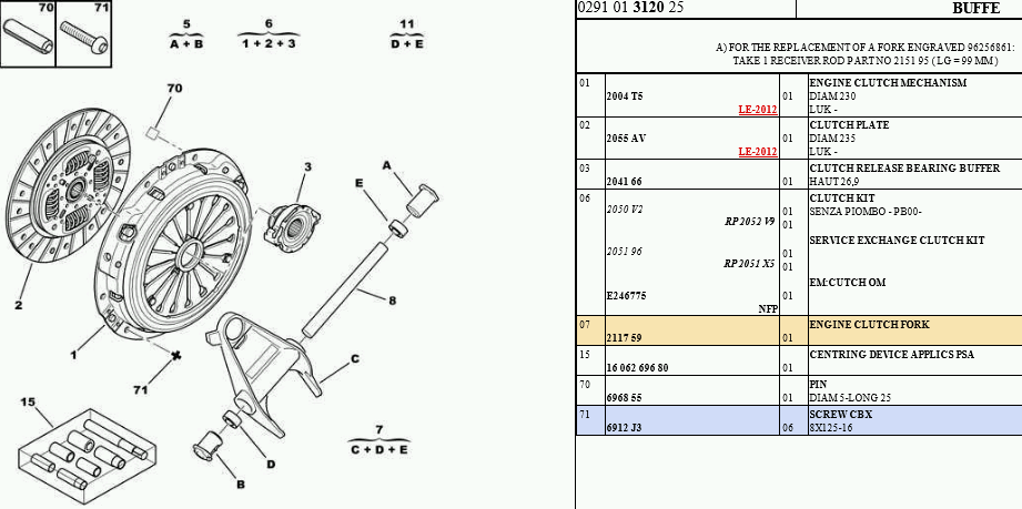

Hi yes certainly.
hope this helps.
Sent from my GT-I8200N using Tapatalk
hope this helps.
Gun Metal Grey Activa turbo,R.I.P. Gone to scrap yard in the sky and jims garage
Blue Activa from dr.madvibe
Silver Activa lost soul
- x 6948

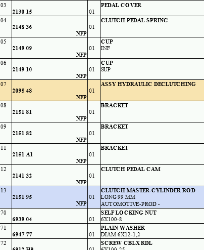

Re: xantia clutch slave cylinder

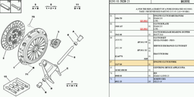

Ok, here's what's listed:
Clutch Diagram & Clutch Parts Clutch fork & Clutch Fork Parts
holmedog
- Posts: 272
- Joined: 14 Feb 2011, 19:53
- x 5
It appears i need the full master/slave cylinder kit. So if anyone has one spare let me know.
No - the above is specifically for the OPs 110 HDi - I believe they moved to Hydraulic declutching on the Mark II HDis

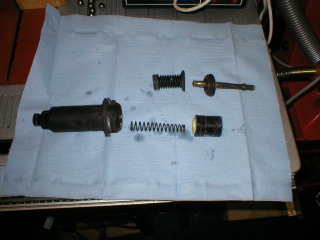

No, you don't need the full kit as I said in my PM...
Anyway, you won't install it without lifting the engine again and stripping a lot out of the way. When new they come in two halves and are joined at the blue metal connector but once they are joined up there is no way to separate them. I know as I've tried very hard to do so.
Also, you should be able to reassemble the save cylinder...

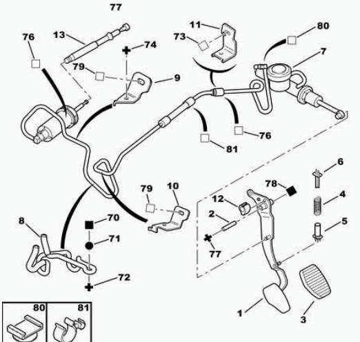

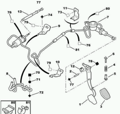

Here's an exploded view:

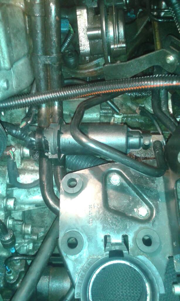

It is easy to check ahead of reinstalling the salve. Look in the slave cylinder hole in the gearbox and look for the end of the release arm. It's bronze in colour and ends in a cup to accept the slave pushrod.
It should only be about an inch (if that) inside the hole and if pushed moderately hard it should not 'give'. If it is deep in the hole then the release bearing is not properly installed. Try pulling the arm back with a hooked tool to see if the release bearing can be pulled into engagement.
This is what the view down the slave hole should look like:
Here, the arm is in about the right position.

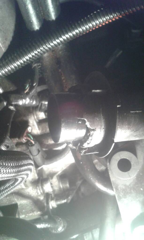

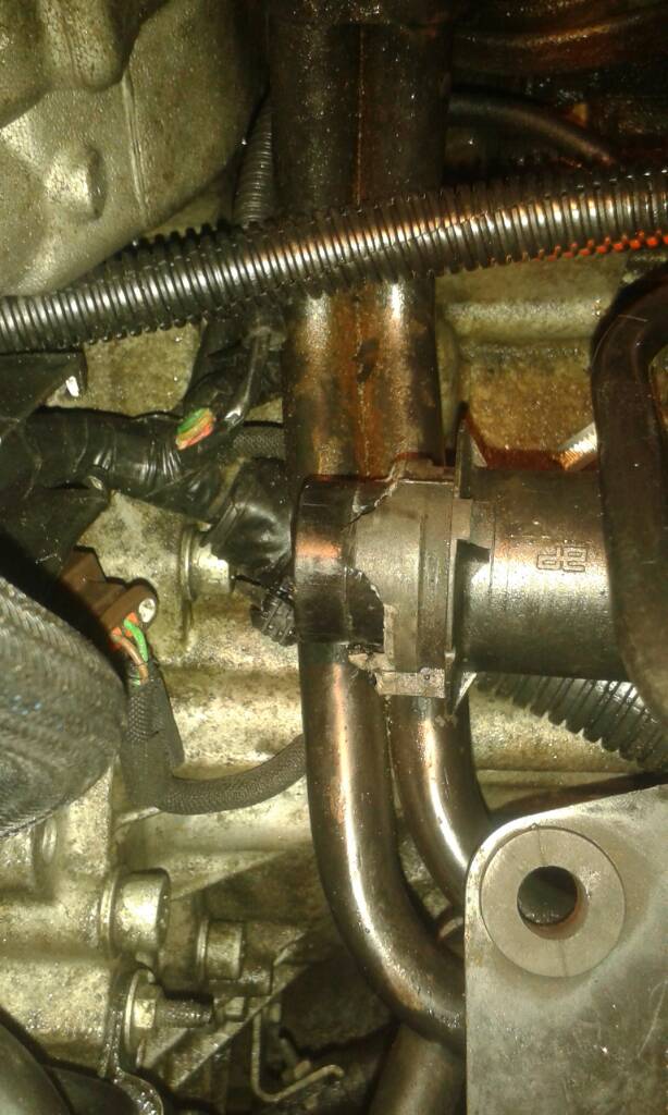

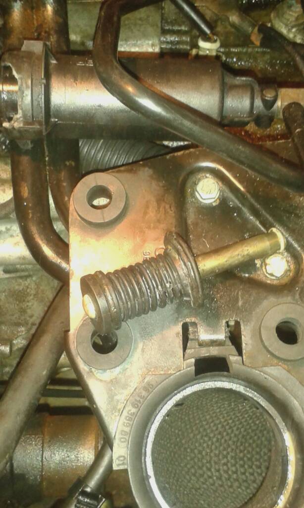

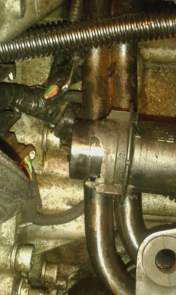

The slave has completely gone to piece's.
As you can see it is in no repairable state. So can i replace just the slave then Jim and then bleed with your method in your blog.

That slave does look a little past its best. A replacement will be in the post to you tomorrow..
So it is possible to separate that part then and replace it with another. Your blog on fitting the bleed screw i get. But how do you separate it from the hex bolt.
- Posts: 55170
- x 8437
Yes, very easily. The metal hexagonal bit at the end of the pipe inserts into the end of the plastic body of the slave via a pinned spigot.holmedog wrote:So it is possible to separate that part then and replace it with another. Your blog on fitting the bleed screw i get. But how do you separate it from the hex bolt.
Drive out the pin, separate the two, recover the special rubber seal and reassemble.
It will be obvious when the replacement slave arrives. Just packed it for despatch...
The pin will be tight and you will need to rig up a couple of mandrels (a small socket and a slightly smaller pin will do) and a G Cramp to press out the pip from the old slave and press it back in.
Go carefully although you can afford to wreck the old one ion learning how the pin works..
