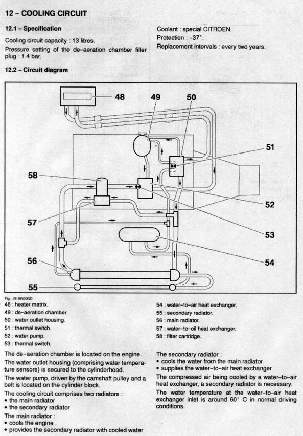

The 2.5 diesel XM, without PTC heater, and now 20 years old, doesn't suffer this way, because the folk who designed it were clever with their pipework*. Both vehicles return the same average fuel usage, 32-34mpg mixed use.
* Warning: sit down before looking at this:

Whats the water to air heat exchanger all about? Is it in the place of an intercooler?
- x 1751
Re: Thermostat???
It is the intercooler, James, by Valeo. Two large turbo air ducts, and a multi-finned coolant circuit radiator inside, and located vertically just behind the radiators.

So somewhere between old fashioned water cooled turbos and an intercooler or just a very sophisticated intercooler? I didn't realise the XM had such an elaborate system compared to the Xantia.
- x 1751
Re: Thermostat???
Citroen documentation claims better cooling than can be achieved from air-cooled intercoolers.
Also has the advantage that, with a cold engine, immediately available and unwanted turbo heat can be transferred to the engine coolant, thus warming up the lump that much quicker.
A reliable bit of kit on the 2.5, unlike the dreadful Valeo aluminium oil-water heat exchanger that sits under the oil filter. The steel 'pancake' versions on XU and XUD etc were fine, but the bigger alu version used on DK5 and 605 were prone to internal perforation, which resulted in engine oil being suddenly injected into the cooling system. Not a lot of fun; happened to me twice, when even a new replacement failed. No longer on the car: a traditional Setrab radiator-type oil cooler has replaced it.
