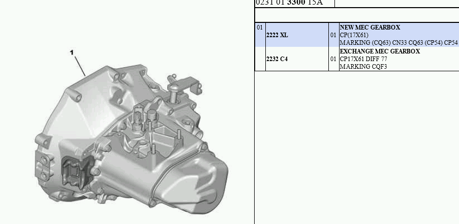

Hi all, I'm looking for a bit of help please. I have a 57 c3 with a faulty gearbox that needs replacing. I'm sourcing the box my self but don't know the code. The Vin number is VF7**************[VIN obfuscated, can be read by forum staff] 28989508. Any help would be much appreciated!

Here is the diagram and part information for you as per your VIN:
