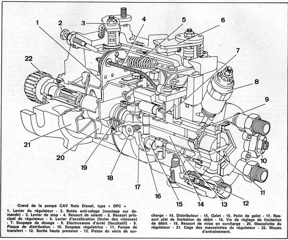

Last check is to bypass the stop solenoid completely by removing the plunger and replacing the solenoid minus the plunger... It'll now be effectively always open...
When you prime (with stop solenoid bypassed) can you see fuel flowing in the return line back to the tank?
Is the emergency stop lever properly 'home' in the run position?
If both of that is OK then it's something internal to the pump.
My assessment would be a gummed-up metering valve/pin... I've known it happen in the past where it was stuck such that the engine would slowly idle and not rev.
The metering valve/pin can be got at without removing the pump; slip off the top cover and it's on the end of the governor (throttle) lever assembly - just south of the spring assembly.
I'd check that before taking the pump off... Not much else really to fail like that in a Lucas DPC and completely stop it...
I have a diagram somewhere if that will help..

Re: Anything Else Before I Swap the Pump
Here's a diagram showing the metering pin (item 7)..
It'll be obvious how to get to it when the lid is off...

Thanks Jim, for the advice and the diagram.
